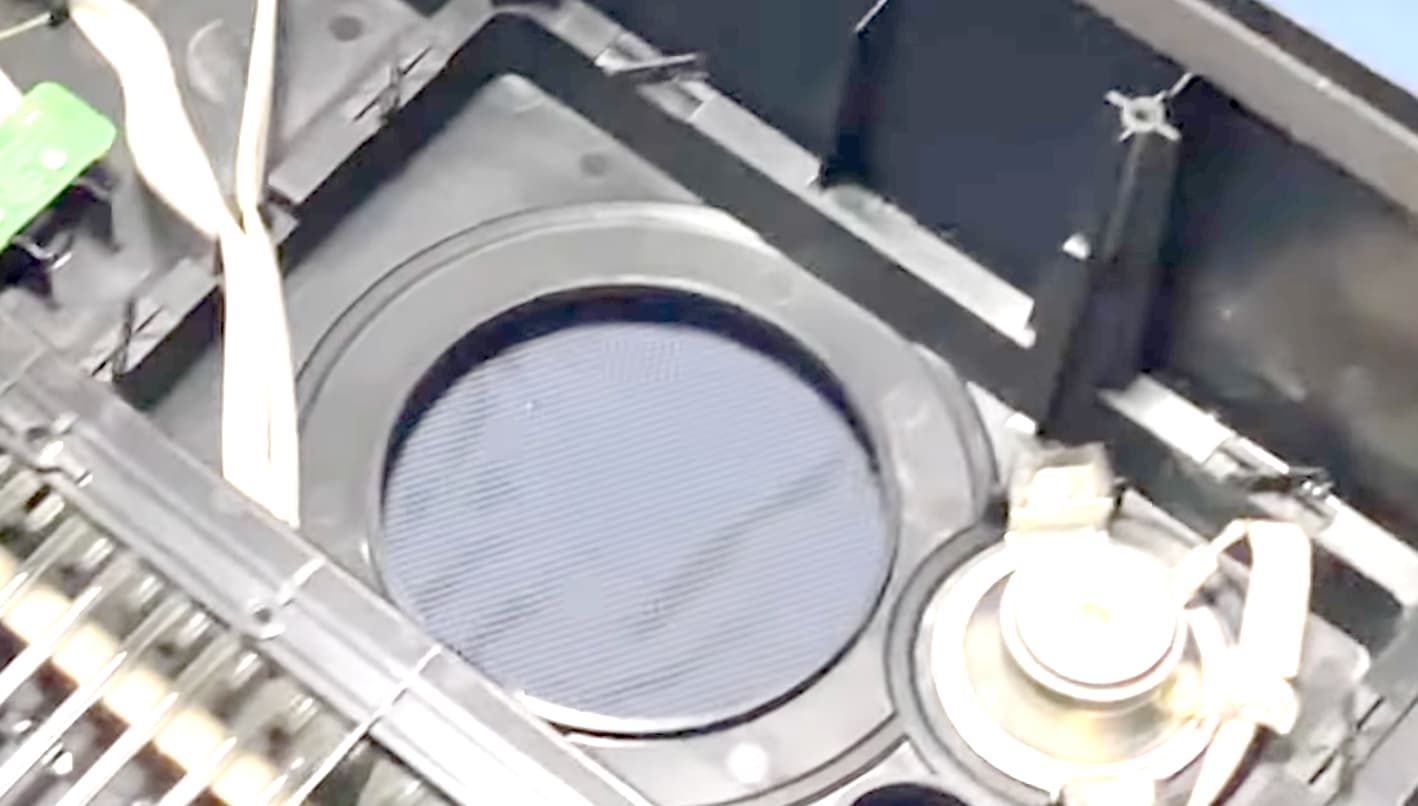

Does anyone know how these grills are actually mounted to the rest of the piano? My hunch would be to try and re-seat the right speaker’s grill to make sure it doesn’t move, but I’m not sure how to approach that. The screws underneath the whole unit seem quite tight, but none seem to be holding the speaker grills in place directly.
I found this video of a repair on youtube but the grills are not touched by the author, and it’s not very clear how they’re mounted. The closest view I could get is at 5:54, but there seem to be no screws whatsoever, just some odd diagonal “tabs and slits” that I’ve never seen before (I enhanced the contrast in this screenshot):
Can anyone provide any tips on how I could approach this? It’s really quite annoying to get that rattle every time I hit that A key.

I would carefully compare the right grille to the left one. The solution may be as simple as a small dab of glue.
I can’t see any difference between them. They both seem to be whole, without any cracks, and trying to “shift” them in place offers the same amount of resistance. Maybe I’m misunderstanding your suggestion, though — what should I be looking for?

It may not be the grille. Rattles can be tricky to pin down but the fact you are able to stop it by pressing with your fingers is a good thing. It could be an adjacent part that is influenced by the pressure you place on the grille. It may take some trial and error but eventually you will find it.
