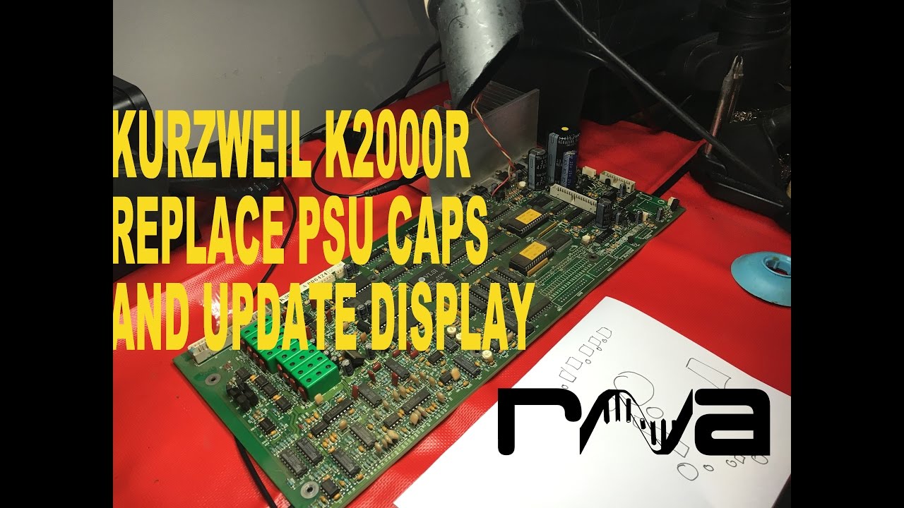

Yeah mine did the same thing so I did a full recap.
