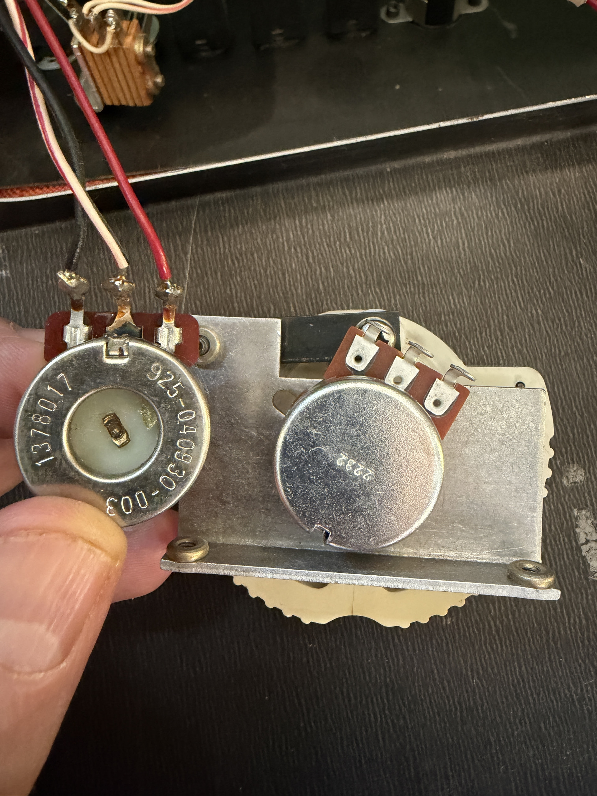

Is the 10k pitch bender pot replacement a direct pin for pin match or do the wires need to be soldered to different pins? Original on left replacement on right pins 1, 2, 3 from left to right in replacement.
Most pots are the same pin to pin, but a quick check with a multimeter should show the same wiring between the two. It will also show if they’re both linear/log.
Thanks for the response and that helped me figure out it wasn’t potentiometer in the end as both read the same resistance. Something else is he problem, modulation works just no pitch bend. Trouble shooting the circuit path. Do like Moog design it’s like it was made with service in mind really easy to work on.
