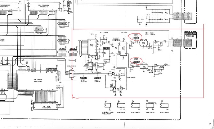

Yeah I’ve got the service manual, so I’m going to start tracing it back from the outputs to try and understand this better.

Tested it a bit more today and found that the Upper and Lower tones don’t split between the U and L outputs either, so I’m guessing it’s not just a reverb and chorus thing which is good for those IC’s! Not really finding many parts at the moment.
There are some test points for the Upper and Lower signals, so I might check those to see if they are at least separate there.
