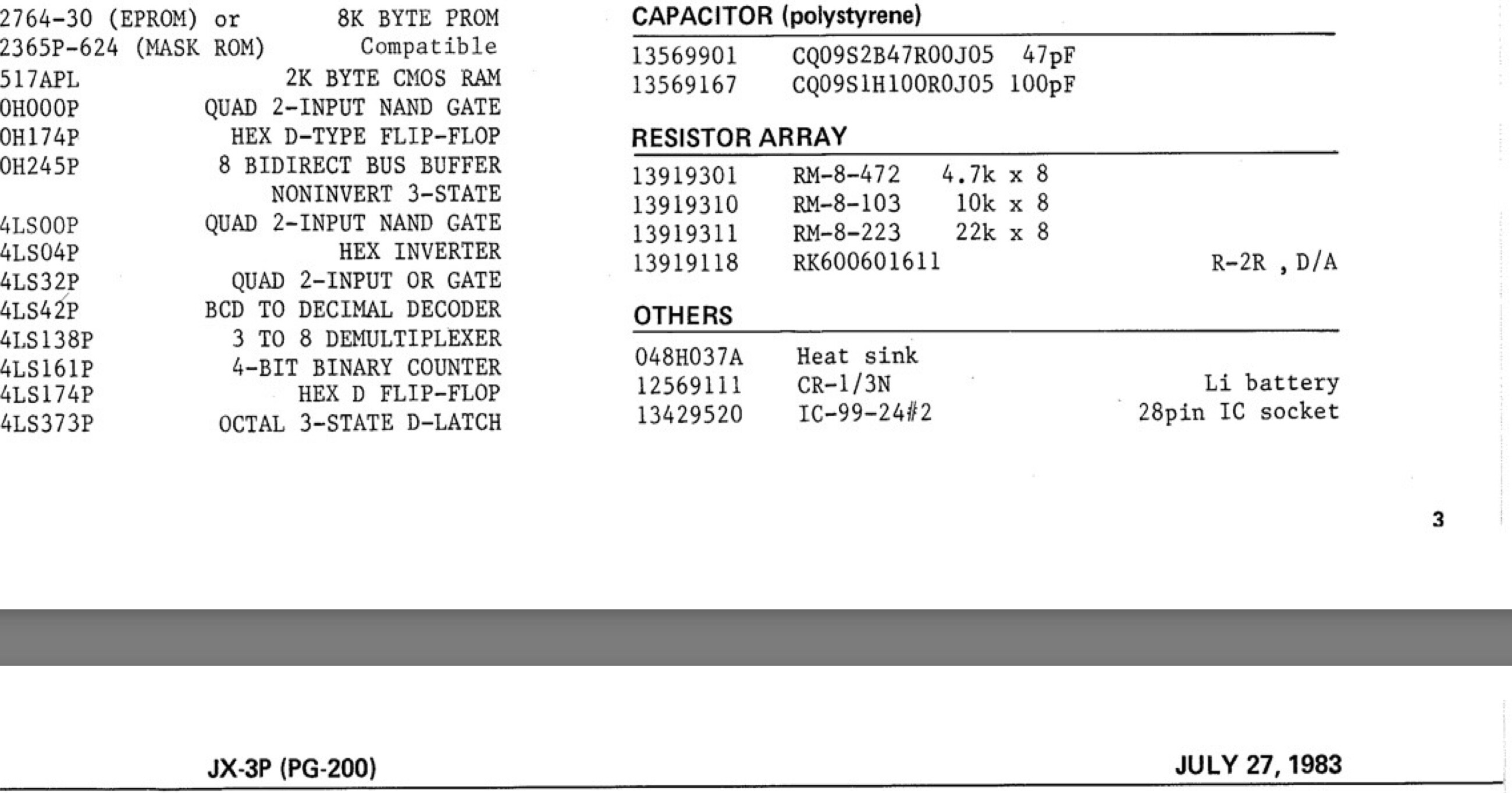

It looks very much like the battery isn’t rechargeable.
The service manual just has this battery connected to the power on the RAM chips.
There isn’t any charging circuitry and the default voltage is 3.3v.

I have changed dozens of JX3P batteries with standard 2032 coin battery and a battery holder and never had a problem. Some synths have rechargeable 3V batteries but the JX3P is not one of them.
You can buy the same battery type new it’s a CR1/3. with leads. The originals were so good that it doesn’t surprise me anymore when I come across one still with full charge and 1983 is a 4 decades ago now!
