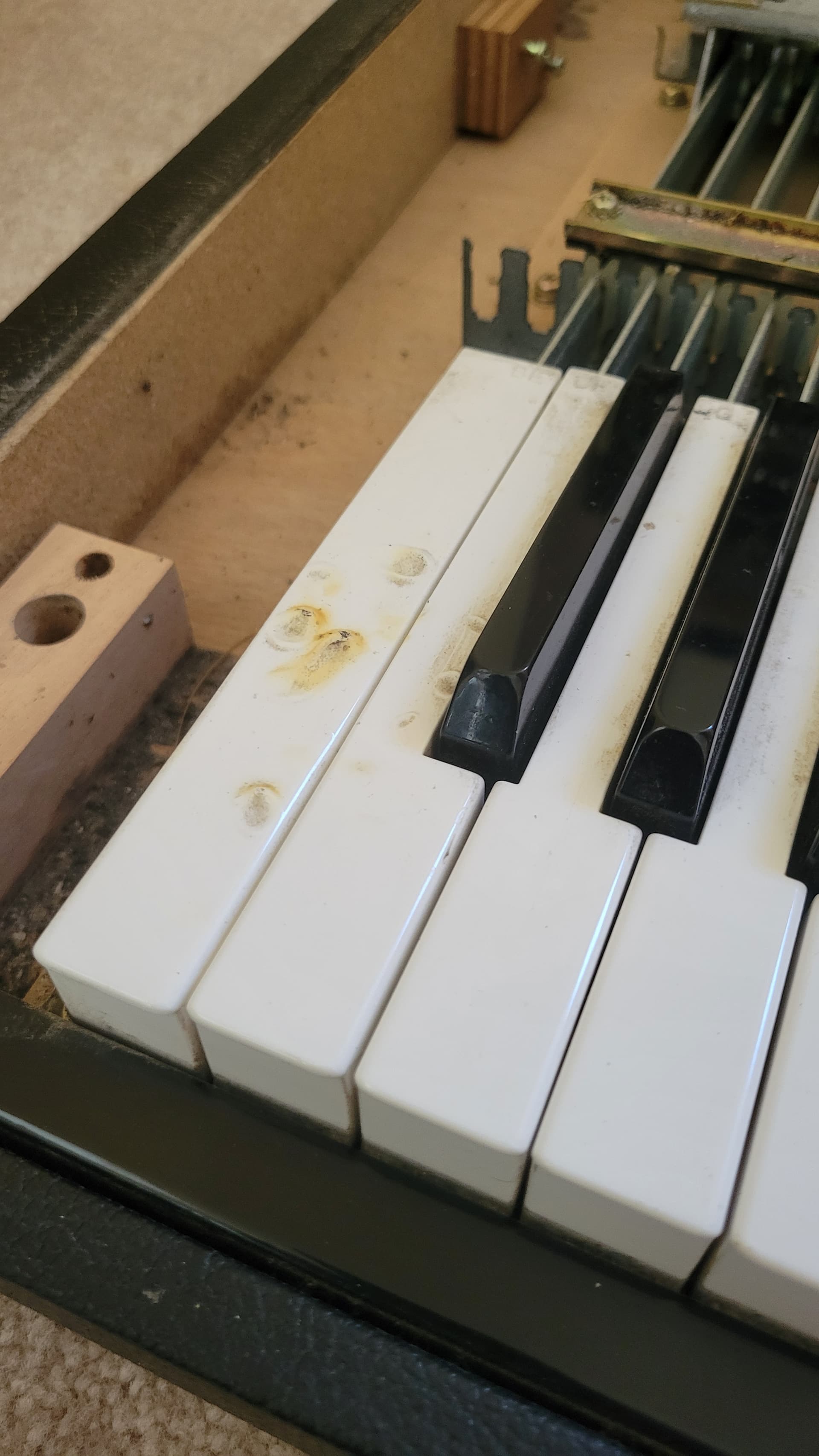

I slotted the head with a dremel and removed the screw with a flat type driver. A left-handed smoker would lay their cigarettes down on a key. Why would you treat your lover like that? I’ve spilled beer on my lovers but never burned them. I guess love is different, in different dungeons.

Yea, those keys will need replacing too. Spares are available I think.
Then it’s time for a good clean!
