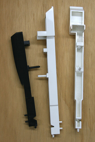

All of the black keys across the keyboard are identical. If it is a Mk II, it most likely uses these keys - and we only have stock remaining of the black keys. You’re lucky!
But look at your keys first, to make sure they are these, and not the earlier Axxe style that uses a metal bracket and a plastic key. Arp liked to mix things up a lot, so there are no hard and fast rules about which models used which parts.
