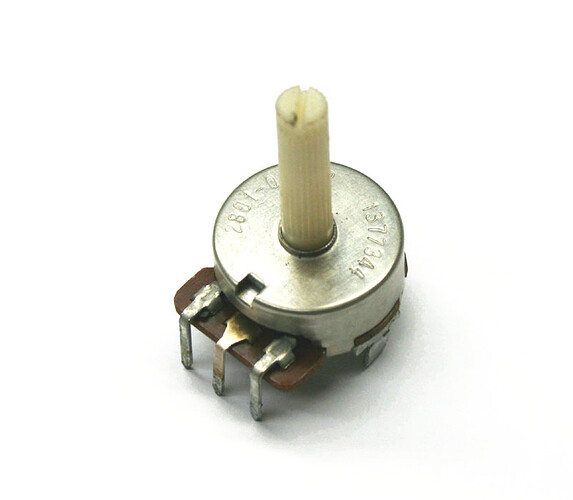

This is what the pot should look like:
It’s a pretty standard pot value (10K linear), but will be hard to find a replacement that is physically identical (same type of shaft, etc.). You may be able to find one that has the same footprint, but a different type of shaft, which might require a different knob. But the knob we sell has a set screw, so it can work with a round metal shaft also.
