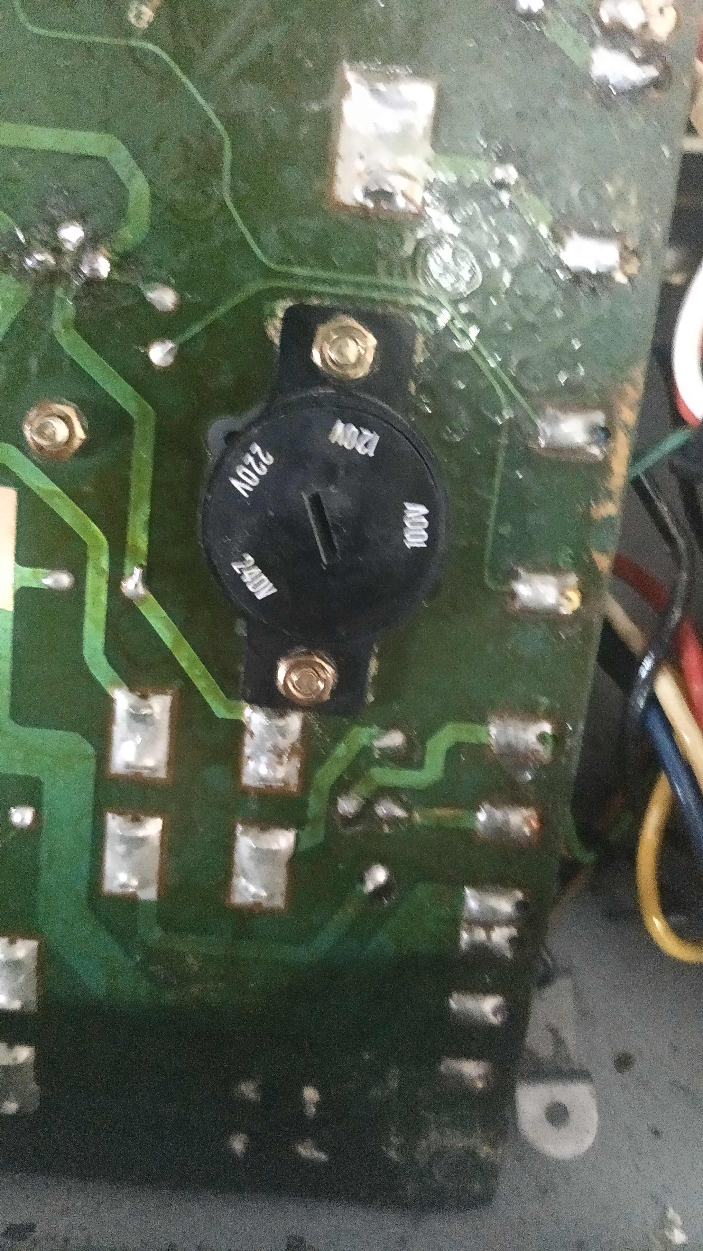

I included a pic of transformer - before I mess with it - i want advice. It has 220v and 100v written on it but on the step-down side it has a lot of wires - clearly many taps for different voltage or different coils. Its a very big transformer for 35w. Is there this possibility that I can just wire it up to be 220v input coil?

Update: So i guess it does indeed take different input AC voltage
On the underside of this plug feeding the power plug rails through to the transformer is a multi-selector … but I don’t know which direction is which. So all that I have now is some kind of problem-solving… what kind of resistance on the coil (or impedance I guess) is going to be the higher voltage. Maybe I’ll get
So pointing to the right is the set voltage and the higher resistance is on the higher voltage. So I put it on 240 and powered it up and its going. Now it has other digital issues - random continuous notes playing. Fun but not fun.
