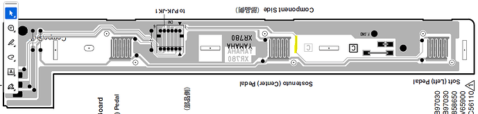

Most common problem is the little circuit board where the three pedals contacts are located. You have to remove the pedal unit, then remove the three pedals and then remove the circuit board. You are looking at the circuit board trace in yellow on the picture - they usually corrode (trace is going black rather than green - compare with others). measure with a meter and if it fails just somehow bridge it with a piece of wire.
