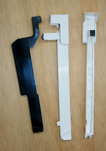

Those springs are very nearly flat - they have a slight curvature when removed. But usually sluggish keys on these keybeds are not a spring issue - it is usually caused by a small crack at the back of the key itself, which then causes the key to sit slightly cocked, and thus not travel as smoothly as it oughta. So I would take a close look (perhaps with a magnifying glass) at the back end of each troublesome key, and see if you can detect a crack where it snaps into place on the chassis. In the rightmost key in this photo, the cracking would occur at the small tab in the lower left corner:
