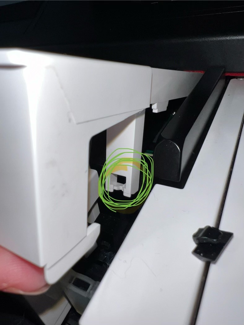

The bad key is the A below middle C and here is a picture of the broken part…
So the top key won’t work?
no, the top key won’t fit.
send a pic of a good white key. It’s hard to see exactly where you say it’s broken. It looks unlike typical keys by yamaha, roland, casio,kawai….
it the part circled is broken off (that’s what it looks like) then you must use epoxy and a piece of plastic to rebuild it. you might consider something like a tab that holds the end of a loaf of bread. It’s strong enough. Or similar.
and what is that black thing laying off to the side?
I will get a pic from the customer. She emailed me out of the blue on this, so I am trying to do everything by proxy until I actually go to her house.
I think the black thing is the part that broke off the bottom of the piano key.

she should remove another good white key and black key, take a picture of them upside down next to the broken key.
