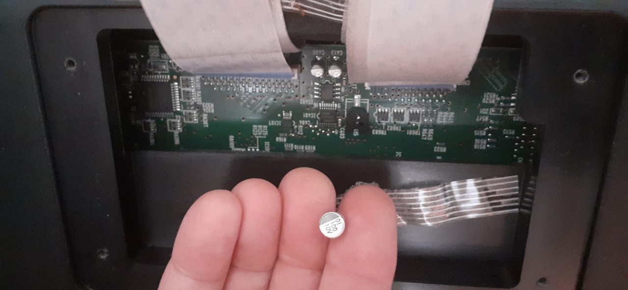

The piano loses the connection to the electricity. It seems to be a problem with the little cilinder sticked on the board
Can it be still be repaired?
Yes, you’ll need to solder a new one in place.
Order a new one, remove the old one from the board and solder on the replacement.
