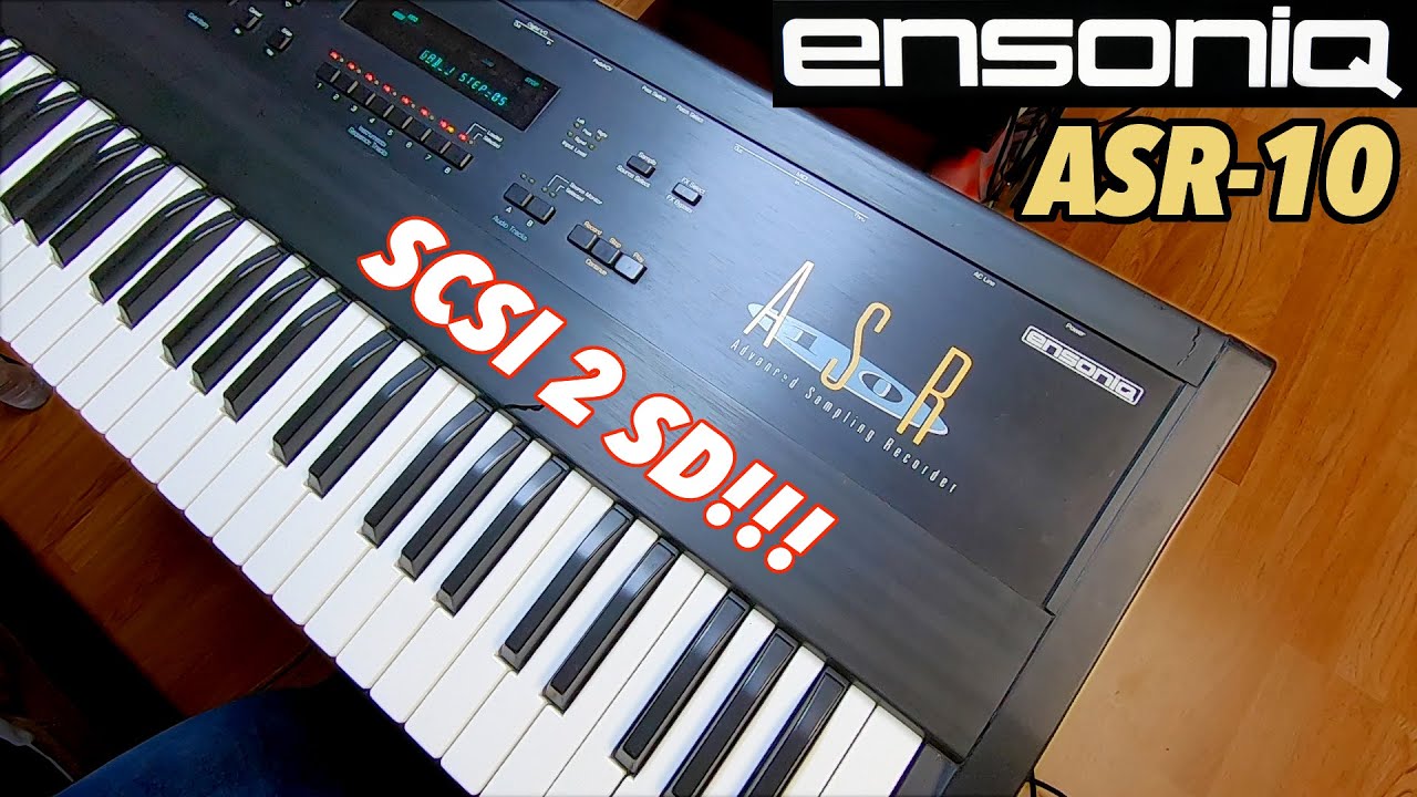

Do you mean something like a Zuluscsi setup? (Zuluscsi took over the market after SCSI2SD stopped being produced.)
This is essentially the same thing:
With a scsi to SD setup you can put the ASR OS on the SD card and save everything to it as well. Makes the ASR faster than even a lot of modern synths and samplers.

Thanks for your response. I installed the Zulu SCSI 2 SD drive on my ASR 10 and it is amazing! Thank you for the information. Sincerely, Big Mike D
