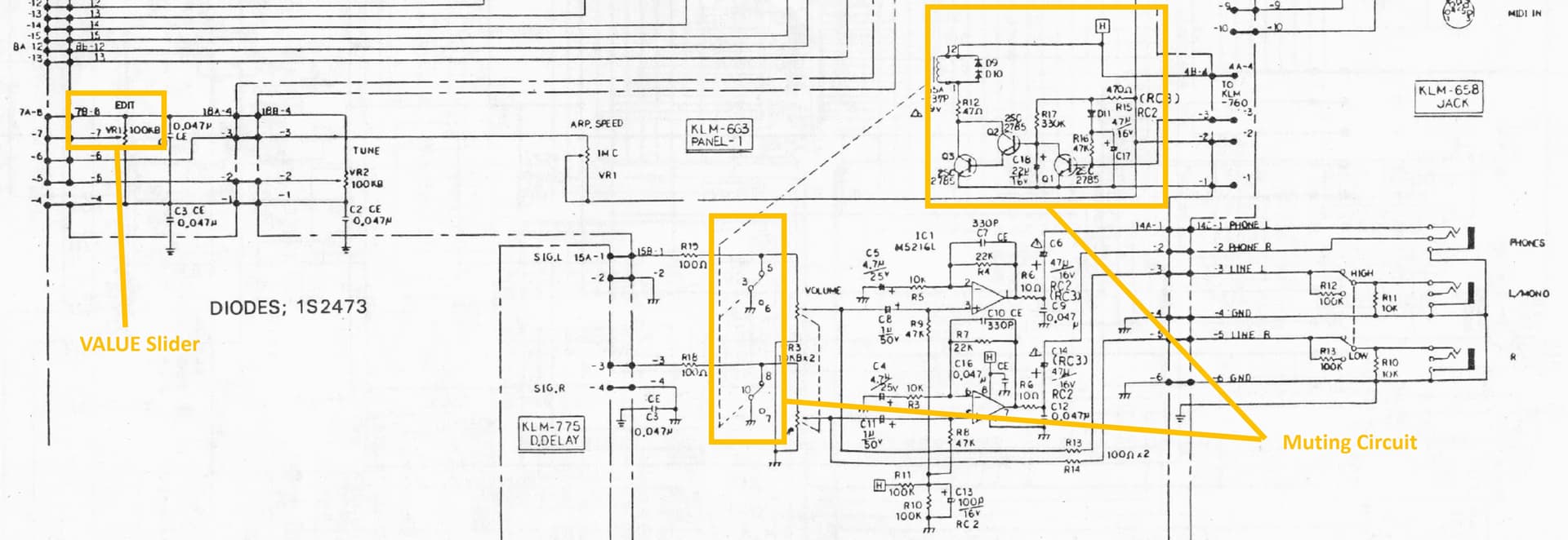

I don’t see any commonality between the Value Slider and the Muting Circuit. These must be two different faults.
However, the signals pass through connectors that would be a good idea to check.

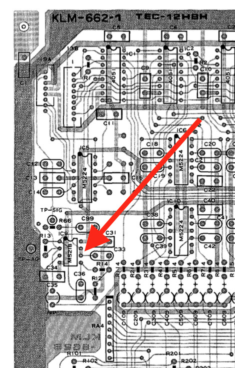

Though the muting relay is a usual suspect I’d check with the scope or an audio-probe whether there is really audio coming from the voices, Pin 7 of IC9 on the voice board KLM-662 should provide the Audiosignal.

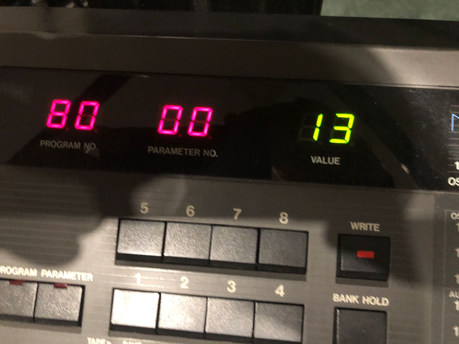

PS: Click can switch DW mode - in tape recording mode! are you control it? can you see “TAPE” at 7-seg.display? or standard info view? likesee below pic.
