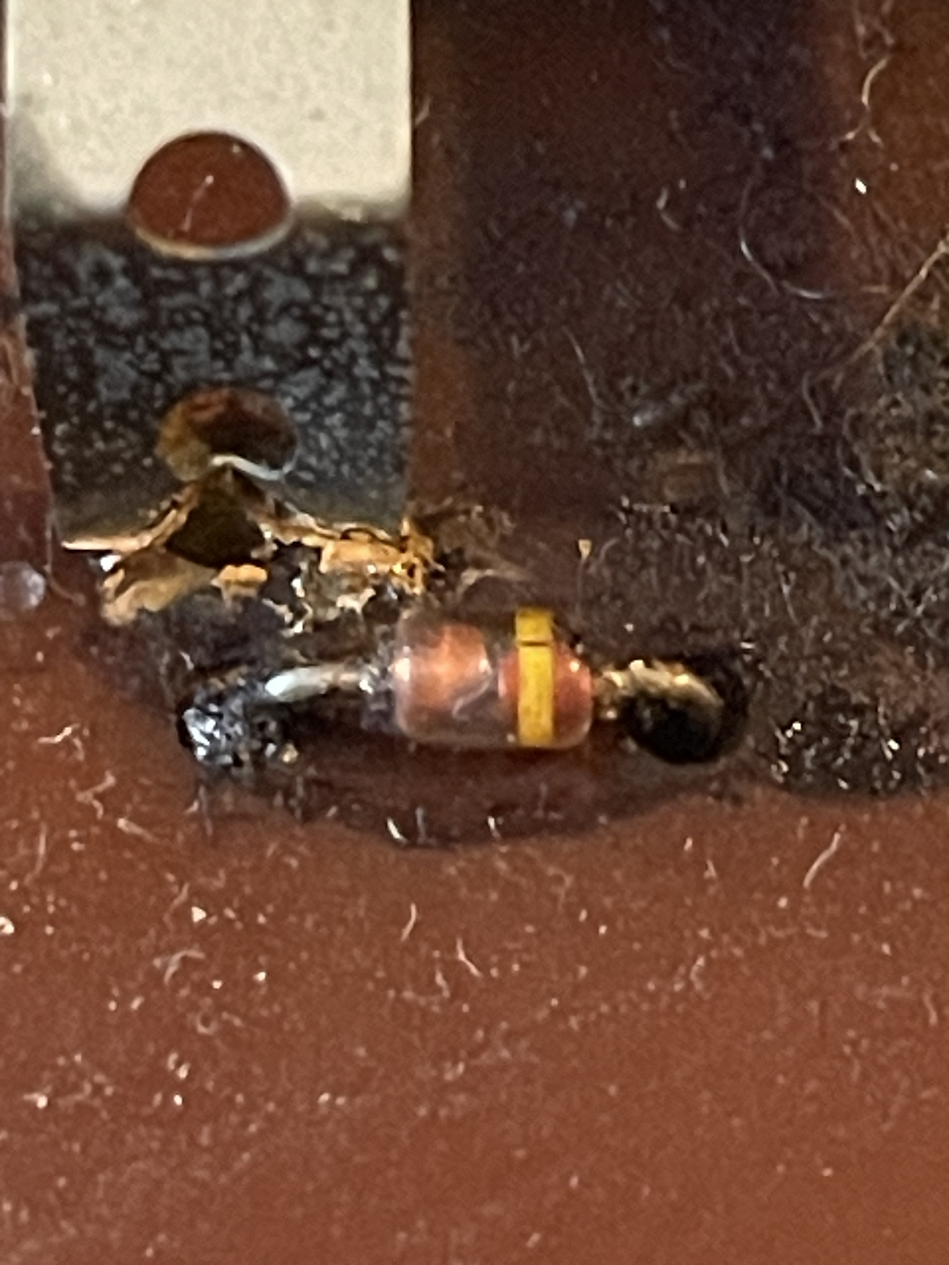

I have isolated the problem to the keyboard ,when I unplugged the ribbon cable the dx7 came alive and all buttons worked.i backtracked checking the cable only to find a short on one of the diodes on the key bed.
Would any one know what type I need to get,I think it’s a germanium diode.
There would be no germanium diodes in a DX7. Well done finding that fault though. If it’s in the keybed it would be run of the mill small signal diode. Replace with the most common 1N4148
Thanks I ordered the correct diode and everything is working much appreciated for the advice.ian
