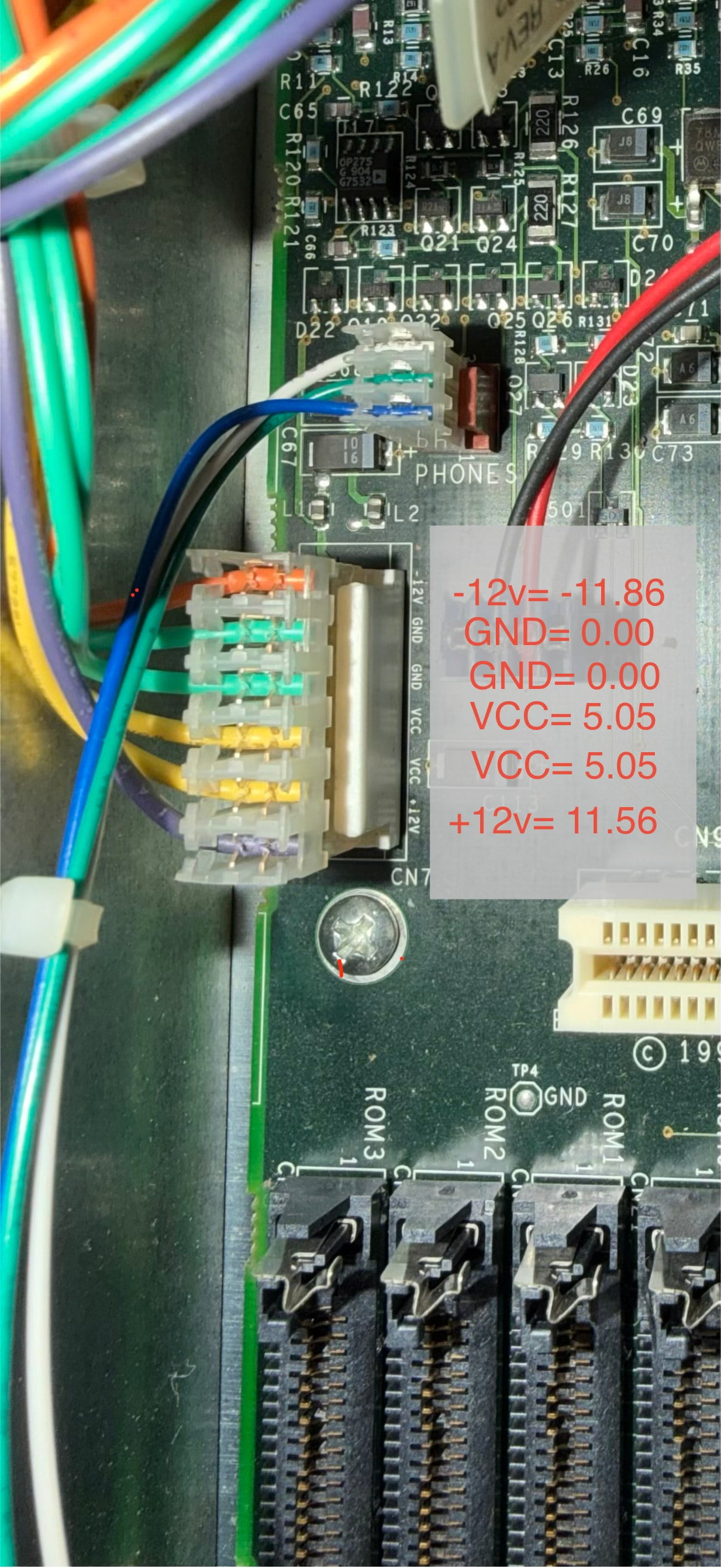

No bulging caps and after putting it all back together I measured the psu using a multimeter and all was at least powered correctly.

Can you test the power supplies Capacitors? Make sure they’re not oozing fluid or bulging on top. It sounds like your power supplies voltage is low. I would check the power supply to make sure it’s outputting the correct voltage. Check each capacitor with a test meter. I had to replace my ASR 10 keyboards ppwer supply capacitors when it’s front panel failed lighting up or booting. That was the cause, Bad Caps! Keep in mind that you can always put more powerful capacitors than the original ones but not lower powered ones of course. Hope this helps you get it up and running again.
