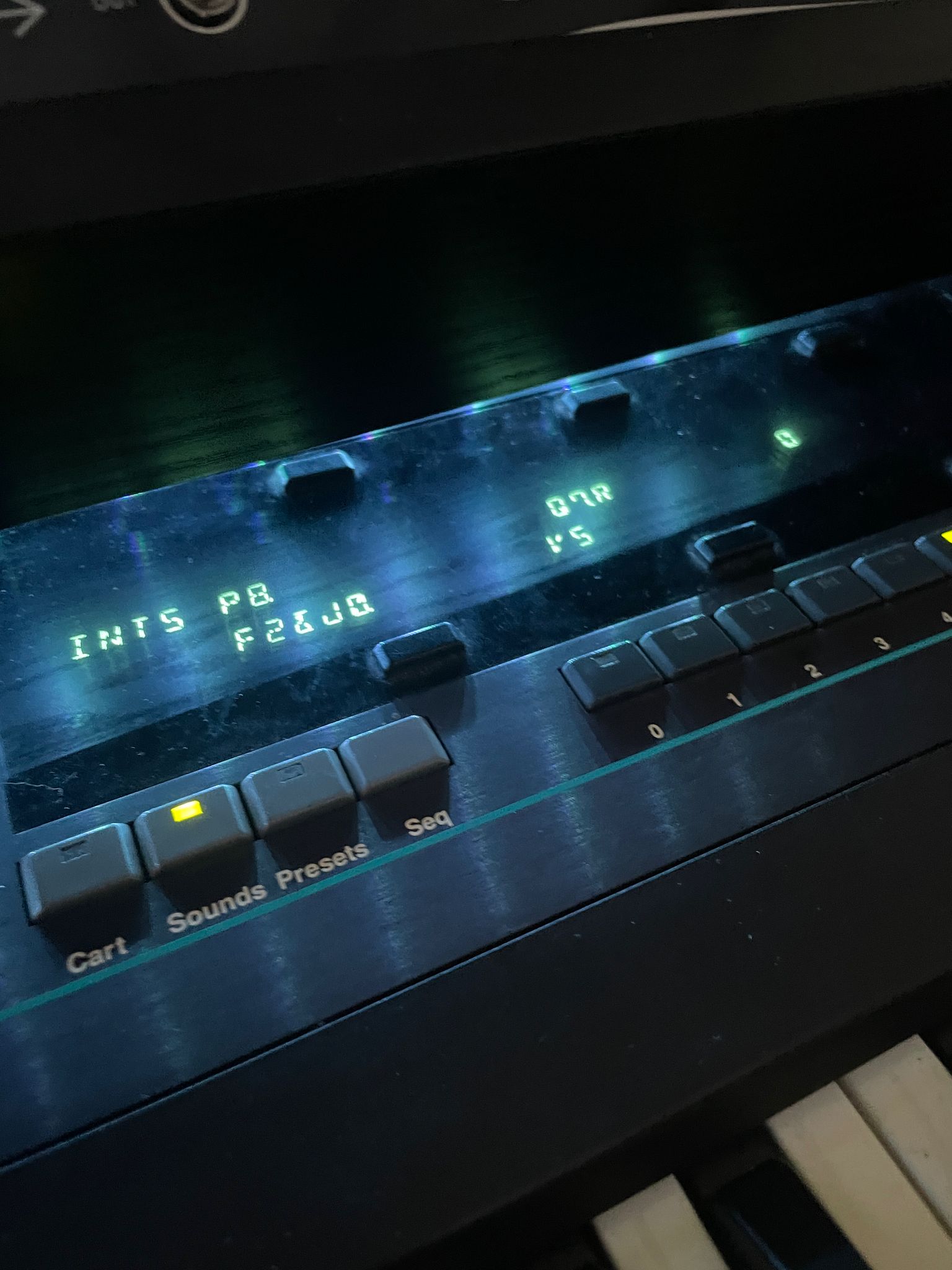

But when I sent the sysex information, the VFX display showed “sysex error receiving files, press any key to continue” - after that, the first row of sounds was glitched. I turned the synth off and on again and now it seems like the internal RAM is botched, it’s stuck on this screen and none of the buttons work anymore. HELP!
I tried a hard reset (presets+soft button) but that also didn’t work… any way to get this thing back to life? Much appreciated
Hi,
You may try the “system reset sequence” : turn the unit OFF then ON slowly (at approx. 2 seconds interval) 7 times. At the 8th time you turn it ON, the unit should reset.
Good luck.
That worked, thanks a lot! I’m still having issues sending sysex messages but at least now know a way to reset it if something goes wrong.

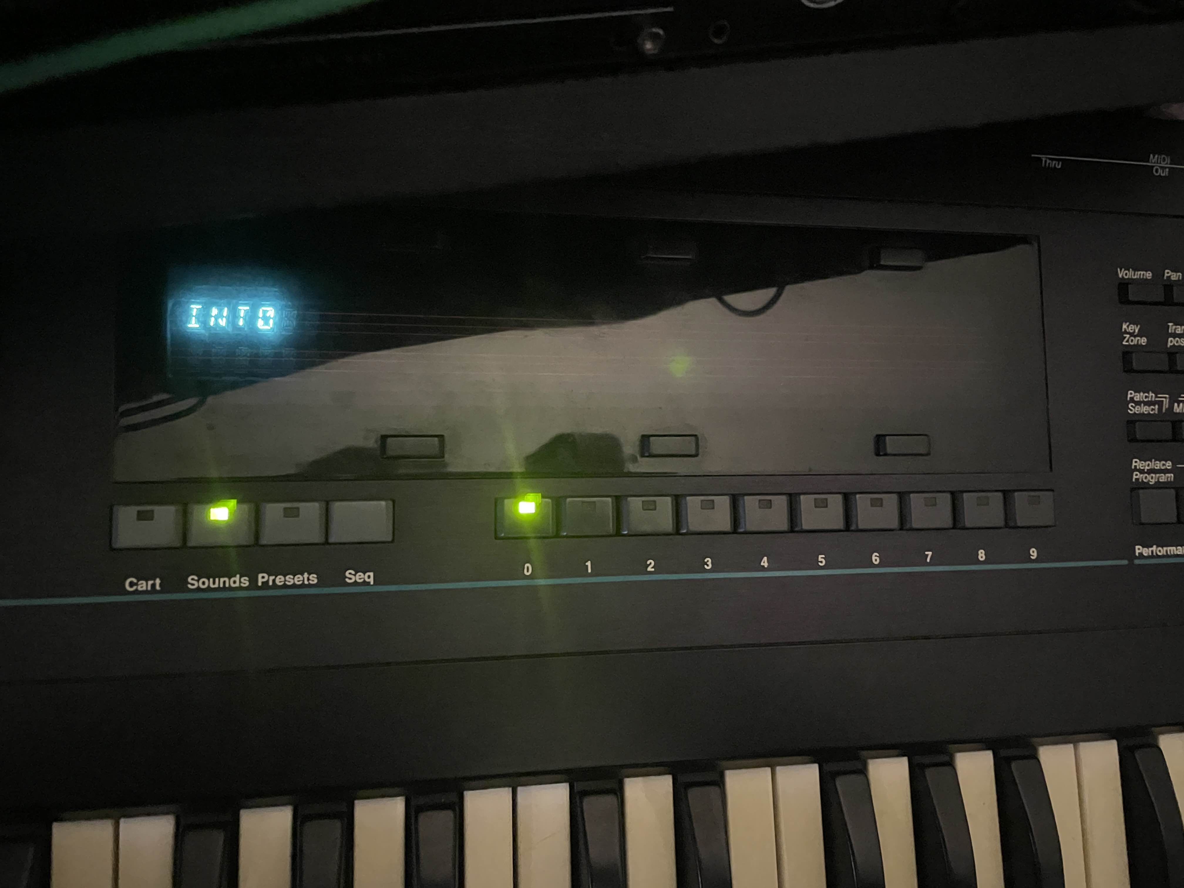

At this point I’ve tried many different files from different sources, for example:
They all result in a bunch of broken, gibberish patches, up to bank 7 - the last few don’t get changed. Sending SysEx this way now does not break the whole synth at least, but the patches also do not work.

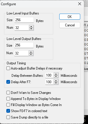

SysEx settings in MIDI Ox as seen below..
I now tried a different software, MIDI Quest 13 Essentials. It offers an editor for the VFX SD, which does automatically detect the synth and is able to get the banks from the synth aswell. But trying to edit or send any data still does not work - the synth shows “MIDI SYSEX RECEIVE ERROR”.
In MIDI Quest, I set a 40ms delay buffer and matched the base midi channel (1).. sysex is also enabled on the VFX. I have no clue what I’m doing wrong.

The issue with SoundQuest essentials 13 software is indeed strange. According to the service manual, page 28, several issues regarding system exclusive were fixed in OS 2.0, and the MIDI Spec was updated accordingly. If your SoundQuest version was published before OS 2.0 (very unlikely) perharps it is the reason your VFXsd reject SYSEX.
Anyway, A simple method to check is to try the following:
  1. Set MIDI-OX ready to receive SYSEX data. Connect only VFX-sd OUT MIDI cable to computer.
  2. Click the Sound button, then double click the Cart button to select ROM sounds bank (Cart button should be blinking).
  3. Select any ROM sound and press System/Storage button, then MIDI SYS-EX, then Programs, finally Current Program. This will send a ROM, “uncorrupted”, program
  4. Connect MIDI cable from computer MIDI OUT to VFXsd MIDI IN. From MIDIOX, send the program patch to your VFXsd and store it to disk.
  5. Reload the program patch to an INT sound bank location and compare it to the ROM original.
Good luck.
