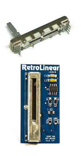

Here’s a replacement method.
Thank you ! I have contacted them for an international order.
Hi, how did the install go with this? Is the slider noticeablely different? I’m thinking of getting one if these to have in reserve should my repaired HPF switch eventually fail.
Syntaur actually sells the RetroLinear kits now:
Thanks - I’ll find a few items to buy simultaneously as the intl. shipping is quite expensive.
