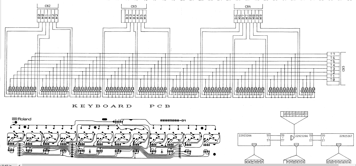

I am quite sure that this is not each second octave only but simply every eighth key (which results of course for certain keys in every second octave). Check with a scope at CN5 whether there are digital signals on the lines T0 to T7

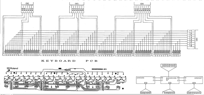

Use this as a guide to find the common traces - left most set of 8 associates with the left most keys E, F, F#, G, G#, A, A#, B - next set of 8 being C, C#, D, D#, E, F, F#, G etc etc etc
highlight each dot where the line from the key meats the select line - then you see the commonality.
