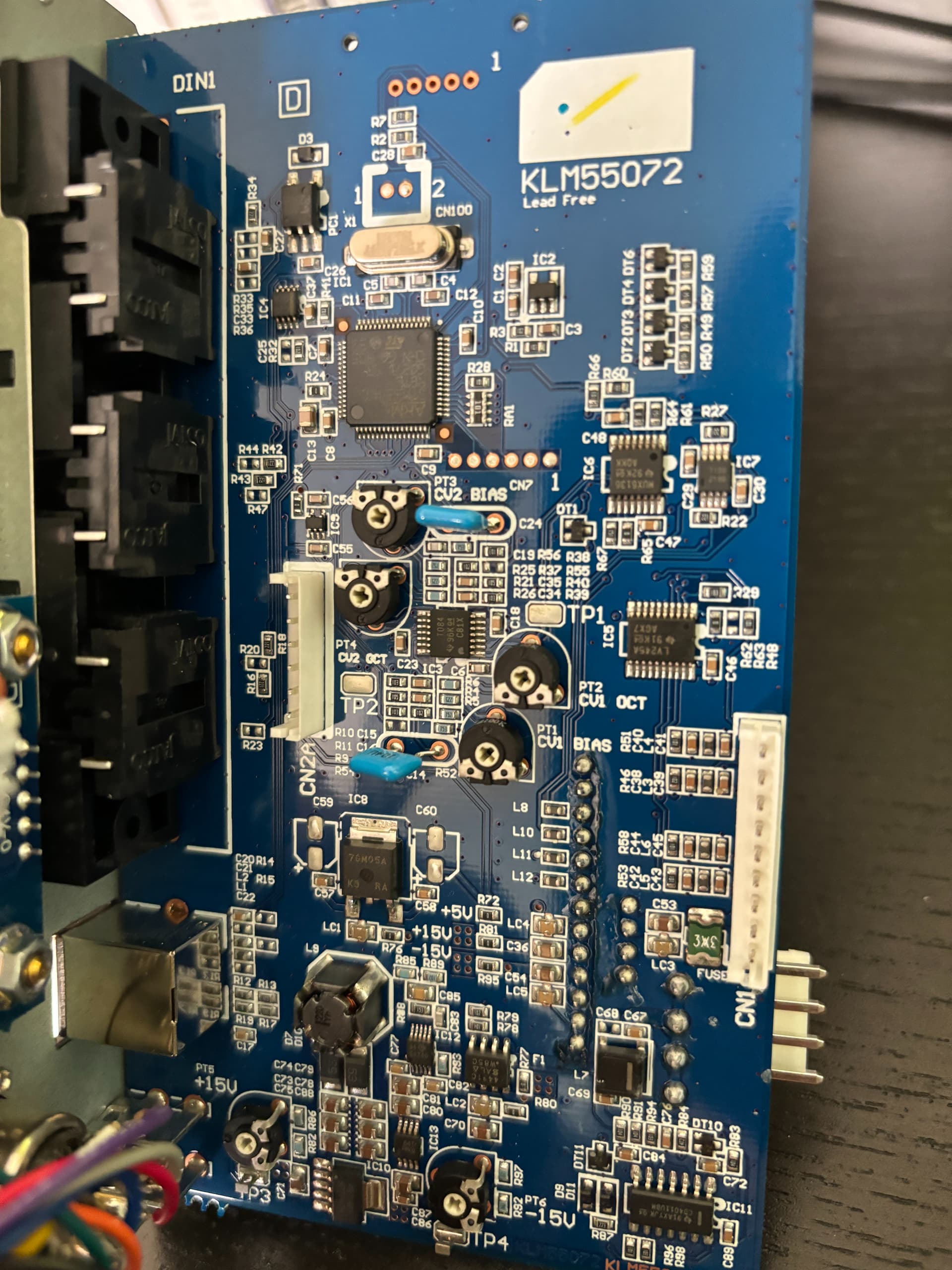

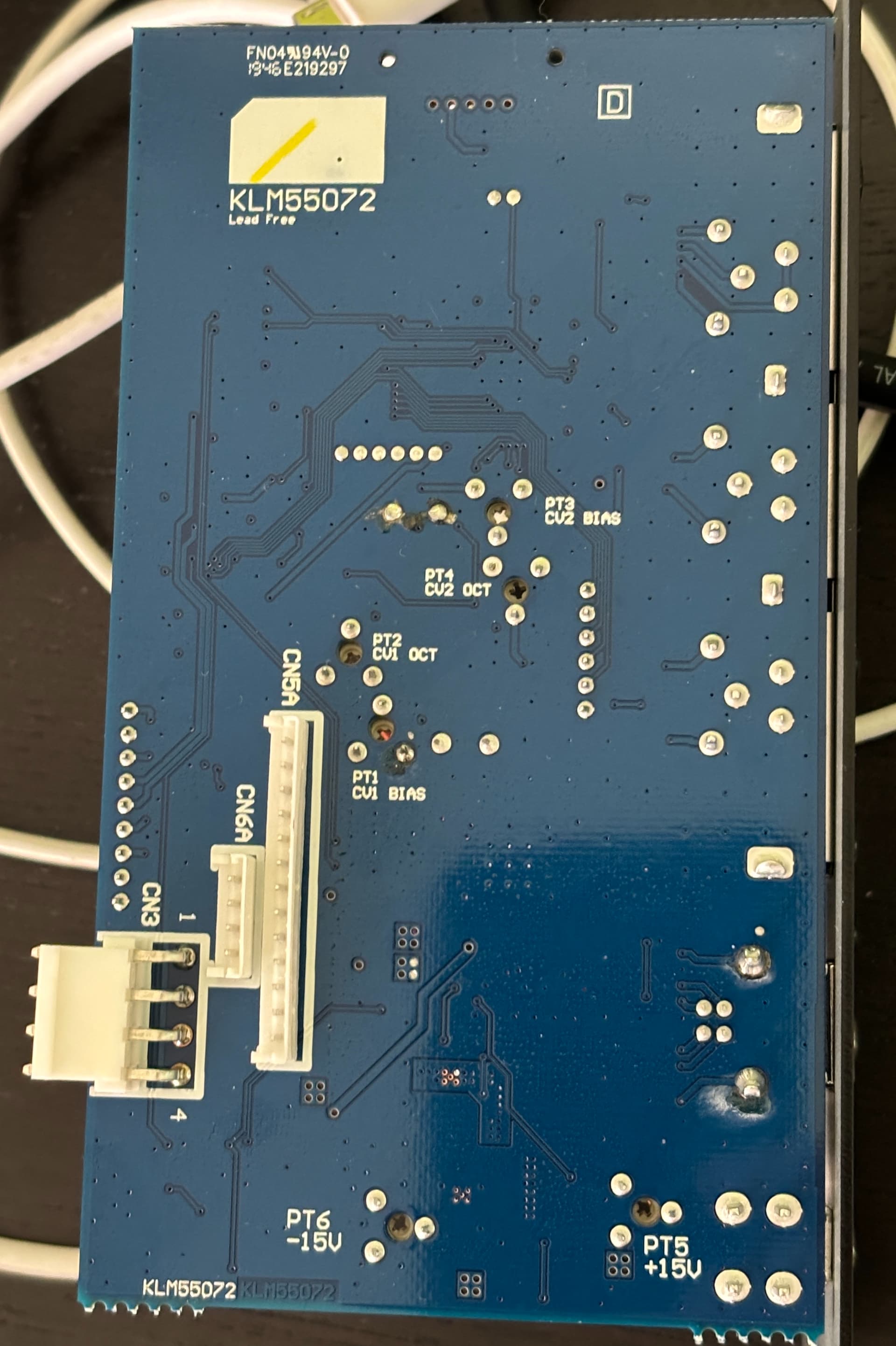

I’ve tried some tests with the 3620 keyboard, midi, and cv sources. The issue seems to be isolated to the 3620 and midi, which leads me to believe that it has something to do with the KLM55072 module, which has the midi, usb, and 3620 connections.

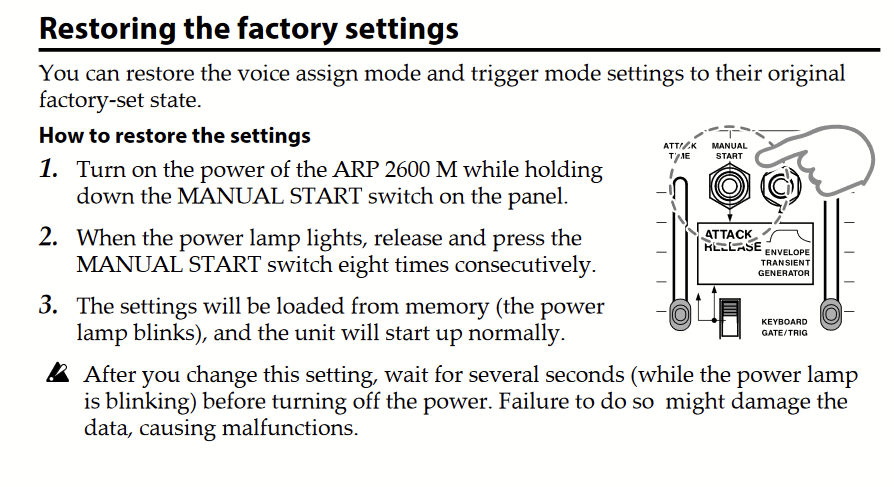

Definitely try a factory reset. Also I’m not sure if this is part of the issue but there is a switch on the keyboard to set the trigger mode. Multiple mode causes retriggering upon playing legato and single produces only one continued envelope any time notes are played legato. Many times I have thought my 2600 FS is bugging out and then I realize I left the sequencer on or flipped one of those switches last time I was playing.

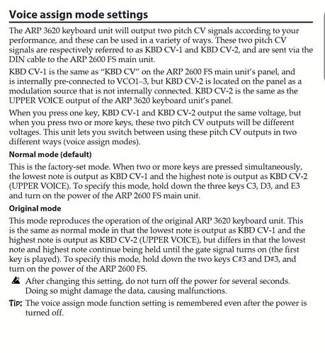

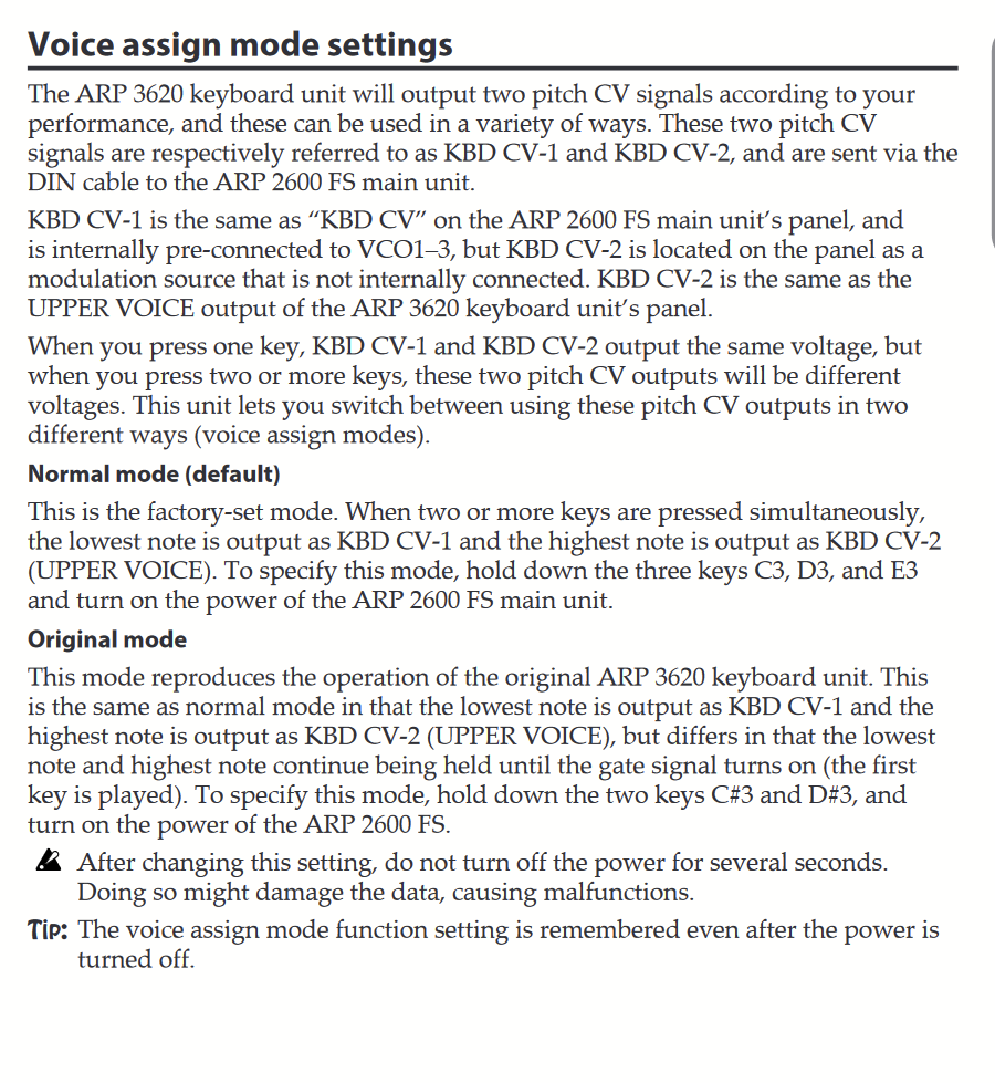

There are also two Voice Assign modes that change the way the software assigns notes, it may be that yours had a hiccup and switched itself off of the default mode somehow. The factory reset will help with that. Page 21 of the owners manual has more info on that.
Thanks for the reply, Travis! It doesn’t seem that the FS has a factory reset function. I just gave it a try to test, and nothing. I think the reset you posted only works for the 2600M which doesn’t come with the 3620 keyboard, so some of the triggering functions are reserved for startup functions involving the manual start button.

Could it be that yours is set to the other voice assignment mode?
If it’s not that, then you’re certainly right and it must be something is up with that KLM55072 board. Sadly that is probably a challenging board to troubleshoot. The CPU on that board handles everything to do with MIDI, CV and USB. This might be a case where a Korg authorized service center is a good choice because they should have the setup and documentation to debug one of their own CPUs. If you have an independent tech who is well-versed with modern Korg they may be able to handle it.

Unfortunately the voice assign settings didn’t help. I’ll see if one of the local shops that does Korg repairs can handle it. Hopefully they have access to a service manual featuring the keyboard/midi input board, Korg couldn’t tell me one way or another whether an updated service manual even exists, smh.
