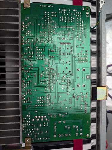

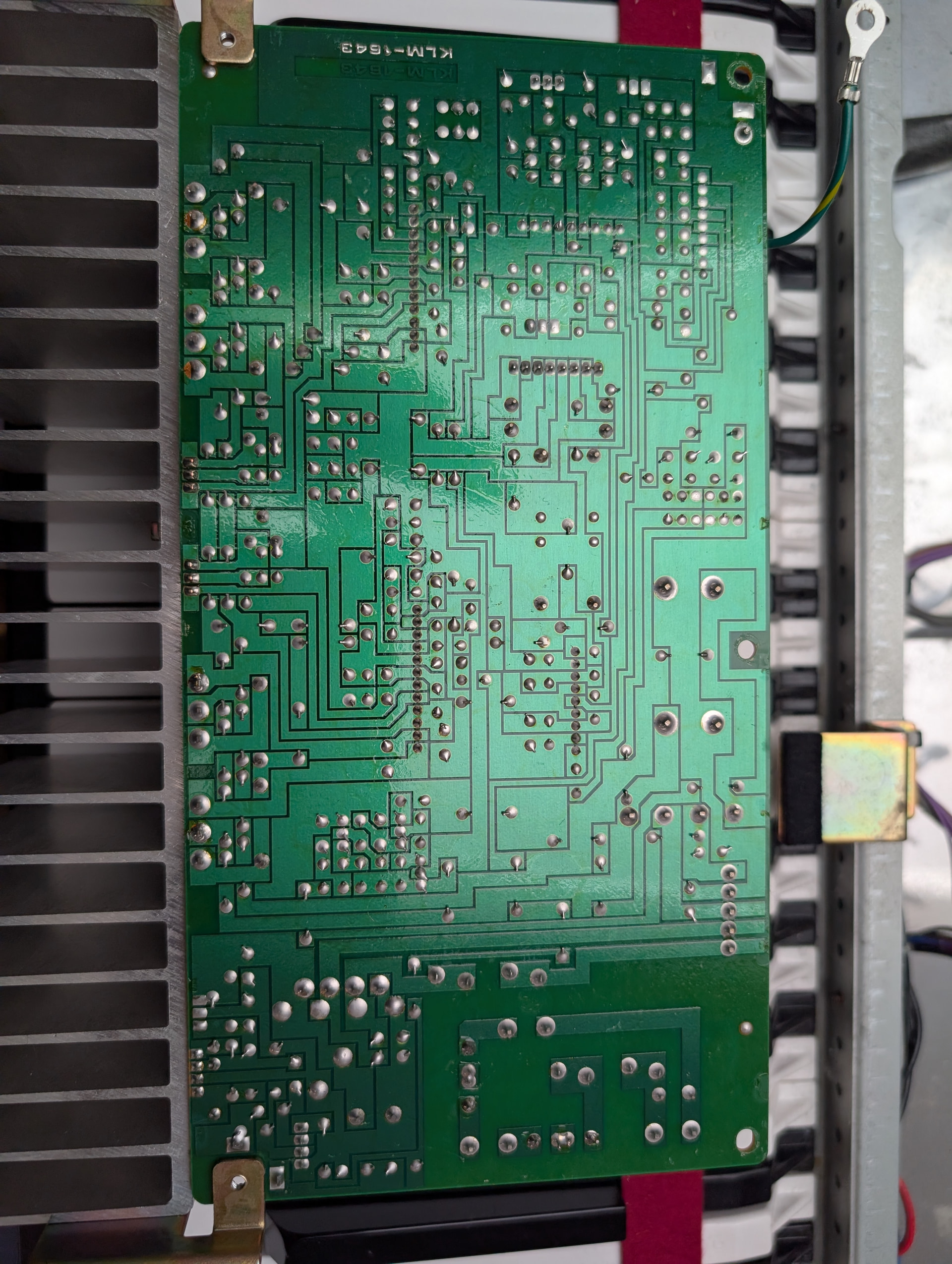

• Symptoms (what changed, when): A couple of years ago, it started to crackle and buzz, and now turning it on I will hear some crackling, but no sound comes out.
• Tests already done (voltages, parts replaced): I assumed it was a capacitor problem, and so I opened it up and removed the amp board (marked KLM-1643 on the underside). No obvious leakage or clear issues with the solder joints. But rather than go through the entire board with a multimeter, I thought I’d ask if anyone had tried to do this before.
• Photos / audio clips:
Do you get the cracking from the headphones/aux out?
If the amp is faulty, these should be fine.
