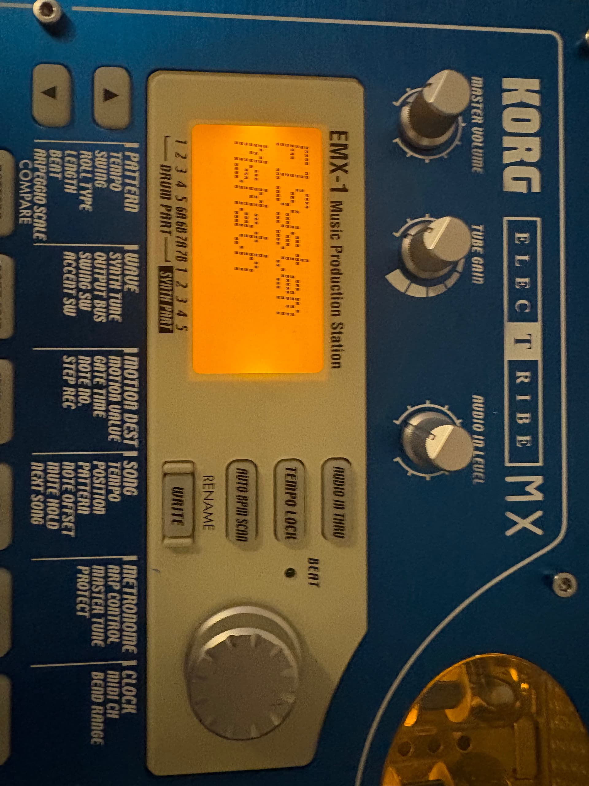

After switching on and during the boot
Immediately a message appears: “F1System MsMath”
I can’t find any information about what it could be.
Does anyone have an idea?

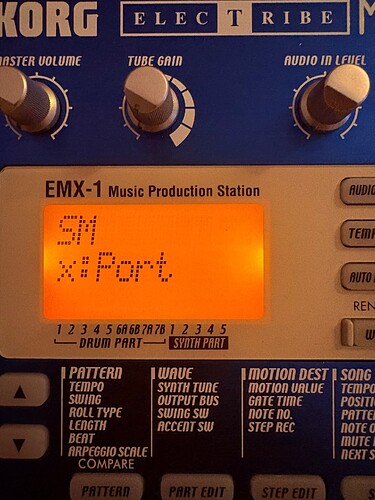

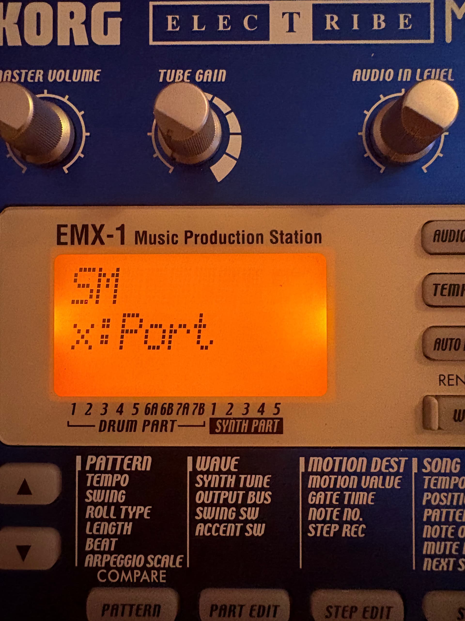

  1. stop or cancel dosn‘t work
  2. I removed SMC, by power on it is the Same
  3. When the Massage Shows non of tip-combobation work
  4. Preload/ Factory→ Solo+ Write → dosnt work,
  5. Erase+ pattern → Working
    → Test of Encoder, Buttons, Display Test 100% functionality
  6. SM-Test Shows errors
Hello,
A shop tried for me to replace the KLM-2366. They get an error because my EMX was a Smart Media and the PCB was for SD version. The CPU is programmed for SD or SM version, if you mix the 2366 PCB it won’t work (need to flash the main CPU and KORG do not share the procedure to realize it). I don’t know if it’s your case, but it may help.
