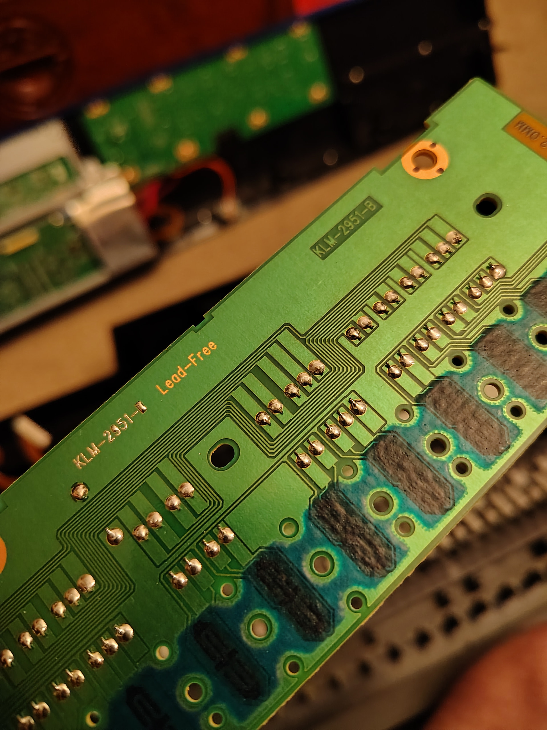

I’m repairing a Korg Krome 88 that was given to me for free due to key contact problems.
After trying to use new rubber contact strips I discovered that many of the contact points on the boards themselves were worn, so I ordered a replacement set of boards. After installation I replaced the contact strips, keys, ect., and… nothing. No sound at all from any key.
I began systematic testing in an attempt to find the problem. First, I plugged in my headphones and turned the volume knob up and down. I can still hear the (very) faint hiss of white noise that changes when I turn the volume knob, which suggests that current is still being conveyed across the audio outputs
Secondly, I checked the velocity meter on the display. Nothing there either, for any key. That tells me that the motherboard is not receiving a signal from the keybed itself.
I then checked the 16-part cable that connects to the new contact boards. All channels are conducting properly.
As I looked at the new boards, I noticed a dark green substance spread over the contact points which is not present in any amount on the old boards. Is this merely a conductive compound, or is it a manufacturing protectant that should be removed?
Also, while removing the small ribbon cables that connect the boards together I noticed that the old boards have FPC connectors that are slightly more bulky than the new ones.
Is this possibly the issue, or is there something simple which I am overlooking (which is entirely possible!)?
Thank you in advance for your advice!
You posted this a while back. Did you figure out the problem. As far as the “New Contact board”. Where did you purchase it from. That doesn’t look right. The contact pads are not suppose to look like that.
