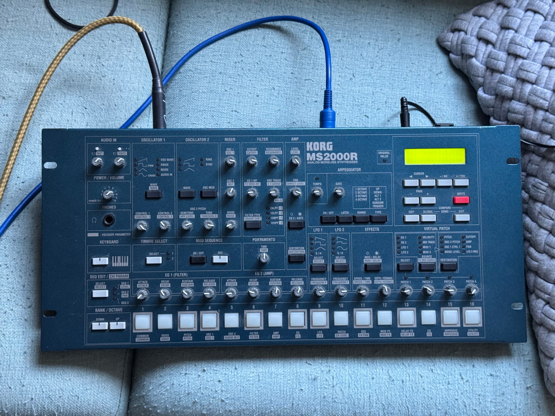

Hi, I’ve pulled my Korg out of storage, it’s in great condition but now upon powering it up it won’t start up. It powers up ok but there’s no sound, no programs to switch through etc

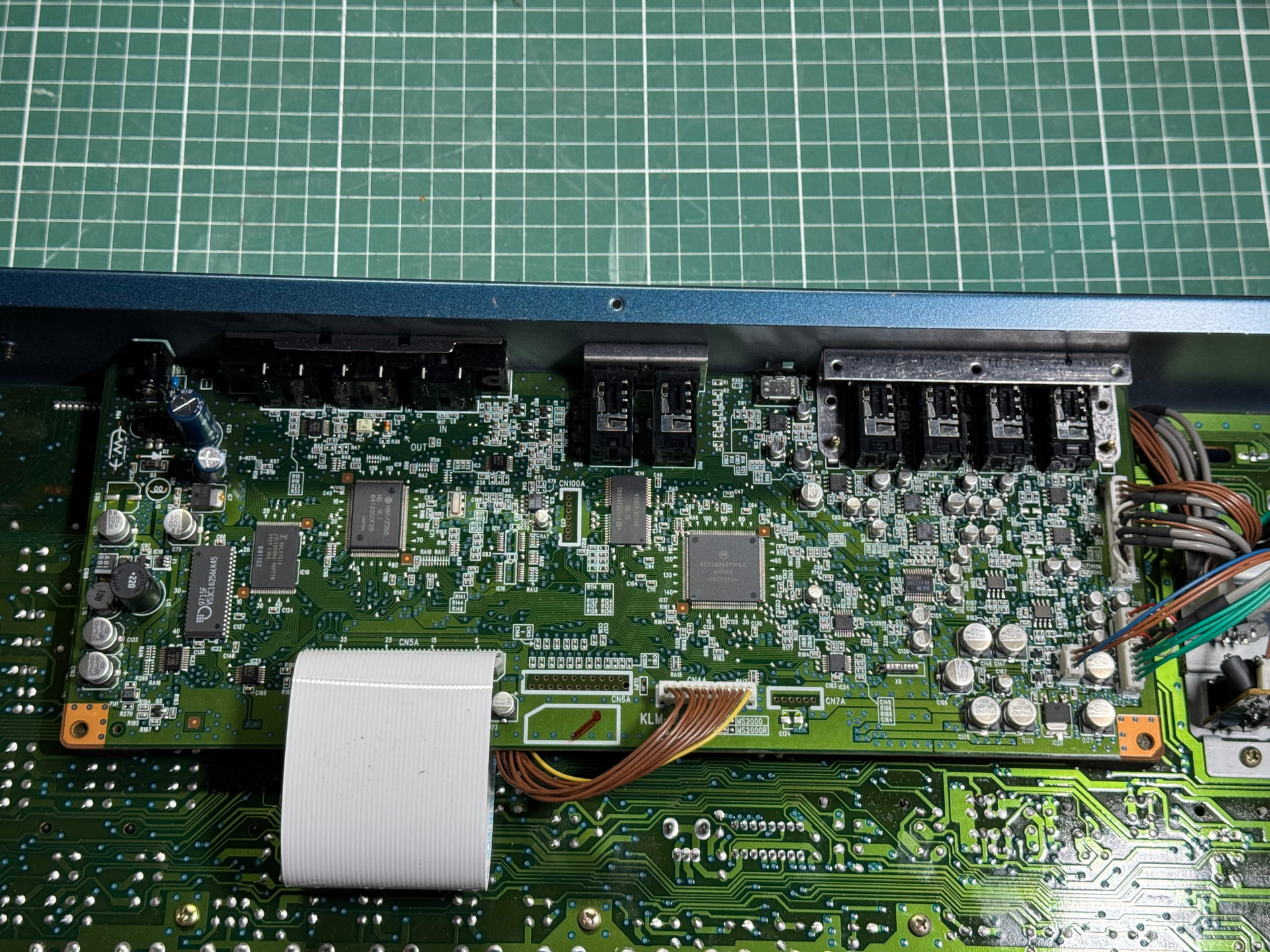

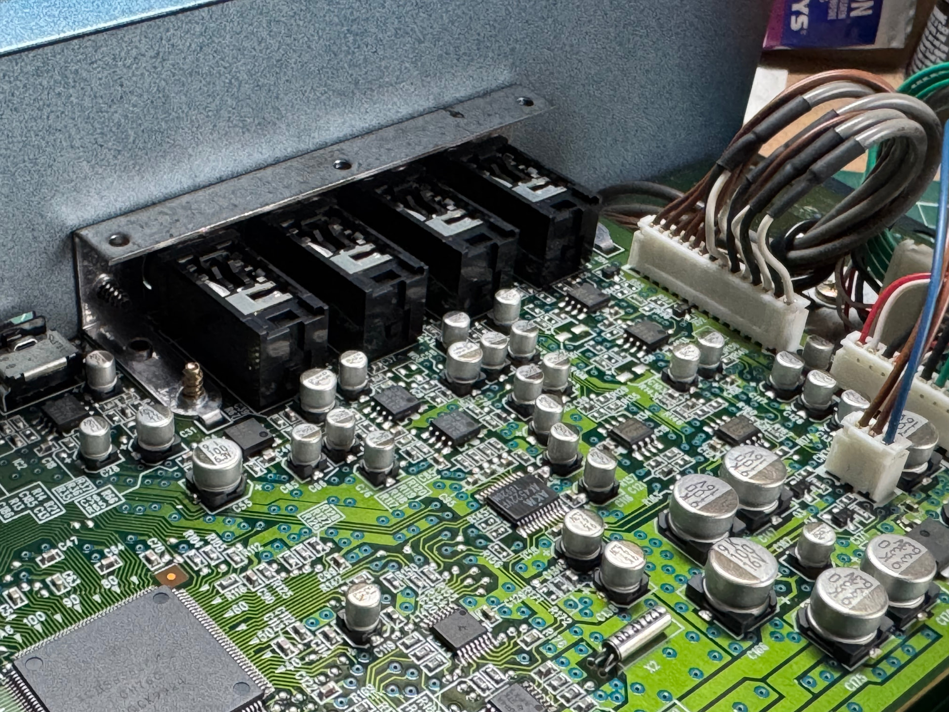

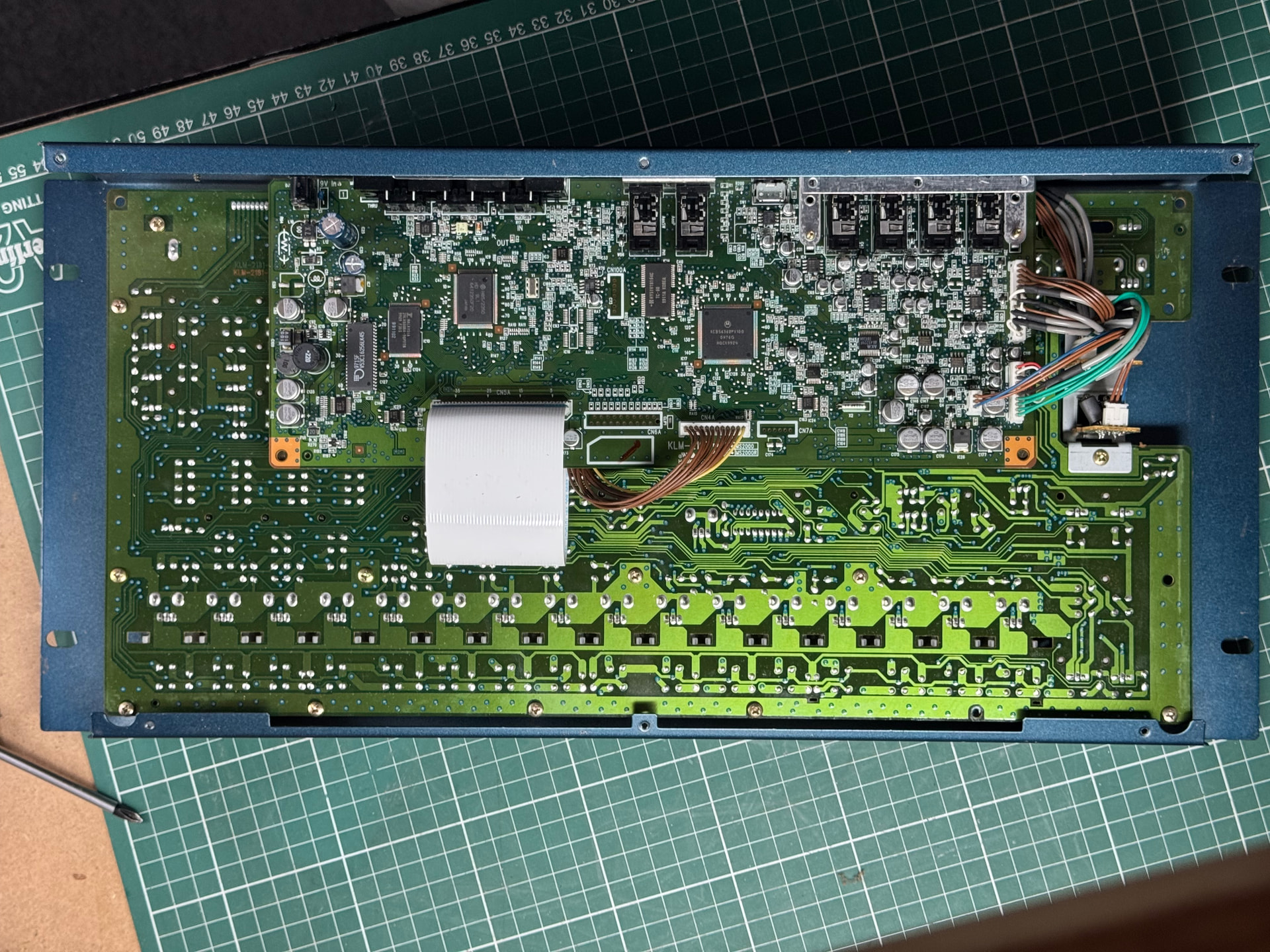

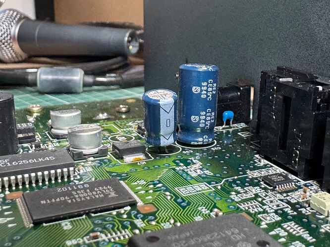

Board seems to be in pretty good condition. I can’t see any broken wires or leakage from any capacitors or similar.
Can anyone point out where the DSP chip is on these boards if it’s pictured?
No the text doesn’t come up at all but the display seems to be working!?
Well you also have a power supply issue just like this one did. You need to solve that first. The culprits are tiny little components the MOSFET marked F1 and switching controller IC15 next to it either or both those is faulty needs changing. Also the fuse marked FU1 is also likely to be gone. You need to fix that before the DSP IC17which is the square chip in the middle of the board. You might get lucky and the DSP is fine after you fix the power. But you got nothing without the main 3.3v power. The service manual with schematic is available with a google search.
