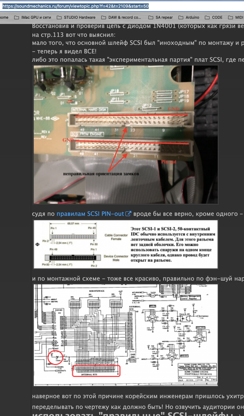

The only material that I would consider useful to share for the Kurzweil K2x power supply is in that old correspondence of yahoo group:
In addition, if your drive consumes more current at startup than the K2000 can provide, you can replace the 7812 scsi 12-volt IC3 stabilizer in the power supply with the 78T12. The 78T12 will provide 50% more current. You can also strengthen the tracks of the 12-volt scsi board with a wire under the board (factory modification on all K2500RS), since they were slightly smaller. Please note that the K2500R uses the K2000R power supply
additionally, there is material on a Russian-language website that talks about problematic or defective SCSI boards from Kurzweil K2x (try to translate using google translate)
this is due to the upgrade of the SCSI_2_SD board too!
and if you register on that website there you will get access to very informative illustrations accompanying these notes.

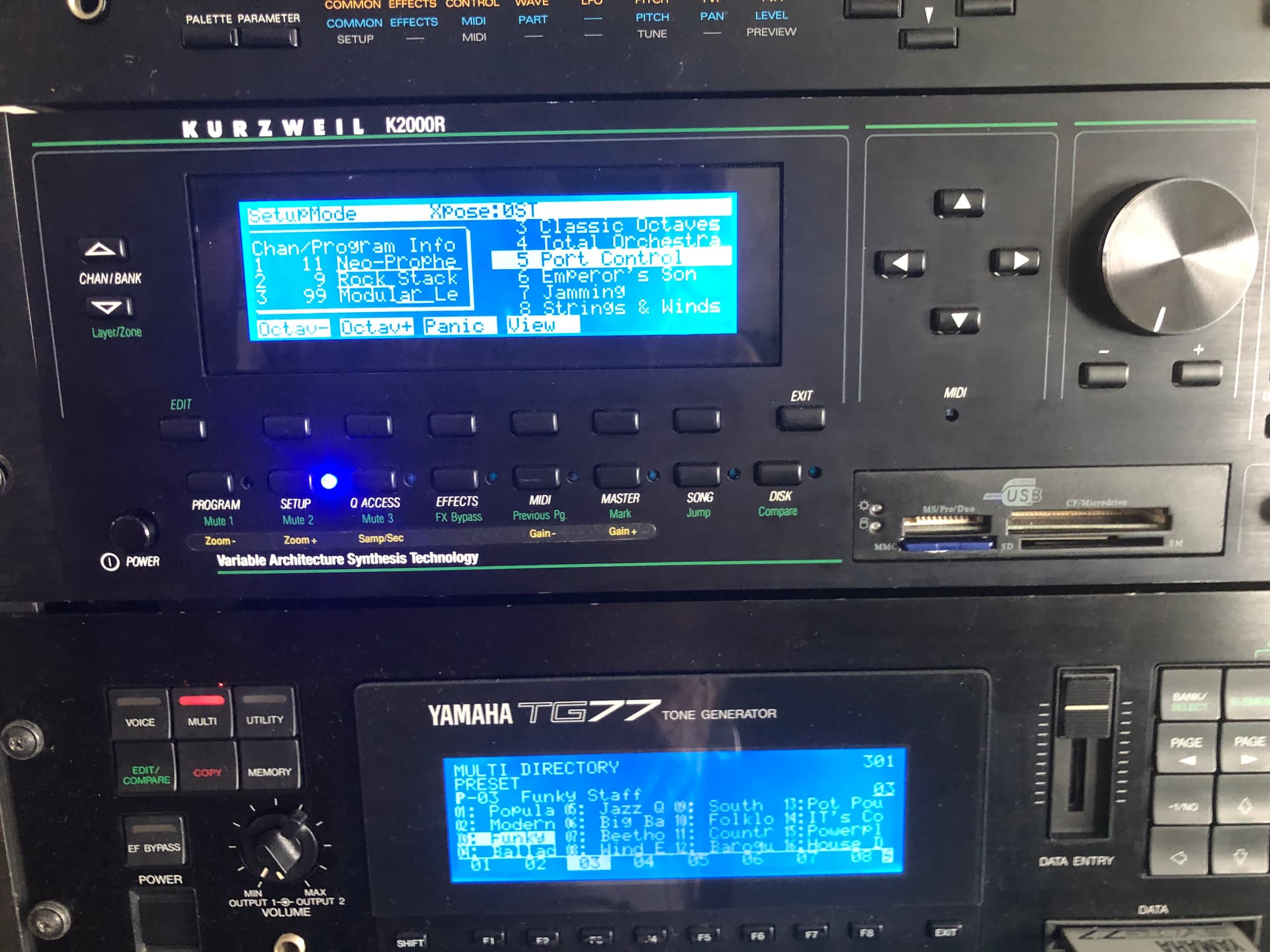

using a flat ribbon cable for SD-extansion and replacing the FDD socket by the old USB multi-card reader, you can install SCSI2SD on an external panel as it is done in my installation:
