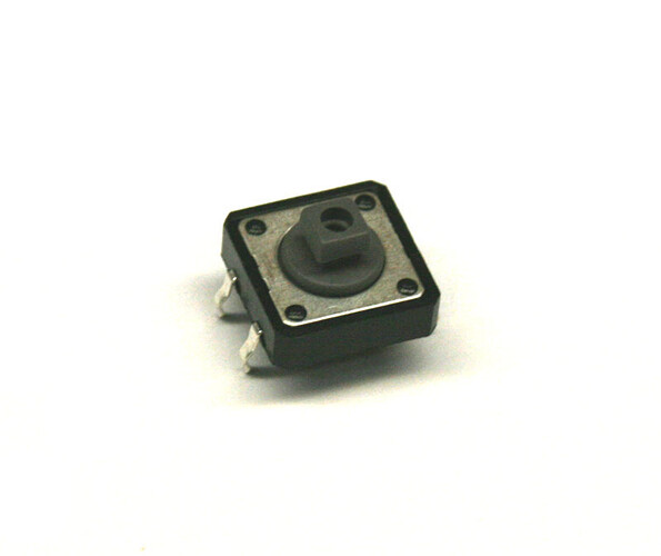

While you have it open, you may want to replace those panel switches that aren’t responding well - they are not expensive, and it will be much nicer feeling those click and make contact. We sell them individually, or in a 10-pack:
Especially when you are trying to diagnose other issues, not being sure if buttons re working or not can really complicate the issue!
