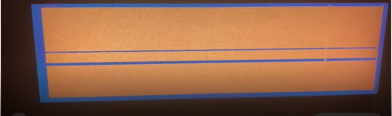

only on this screen
Try removing the battery, leave it out for 10-20 mins, then fit a few one to be sure. That should clear the RAM out which might be full of bad data. But I’ve never seen that on my units.
