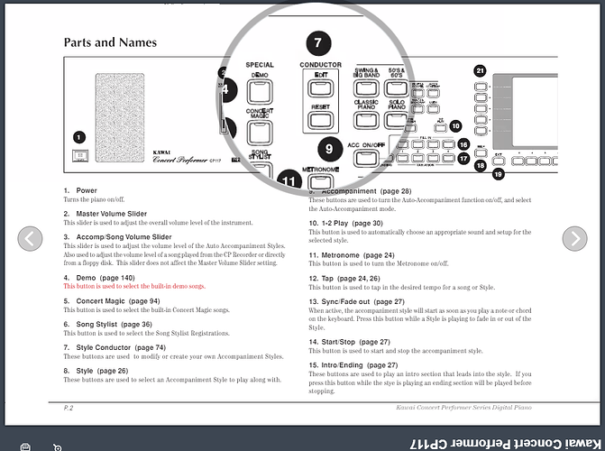

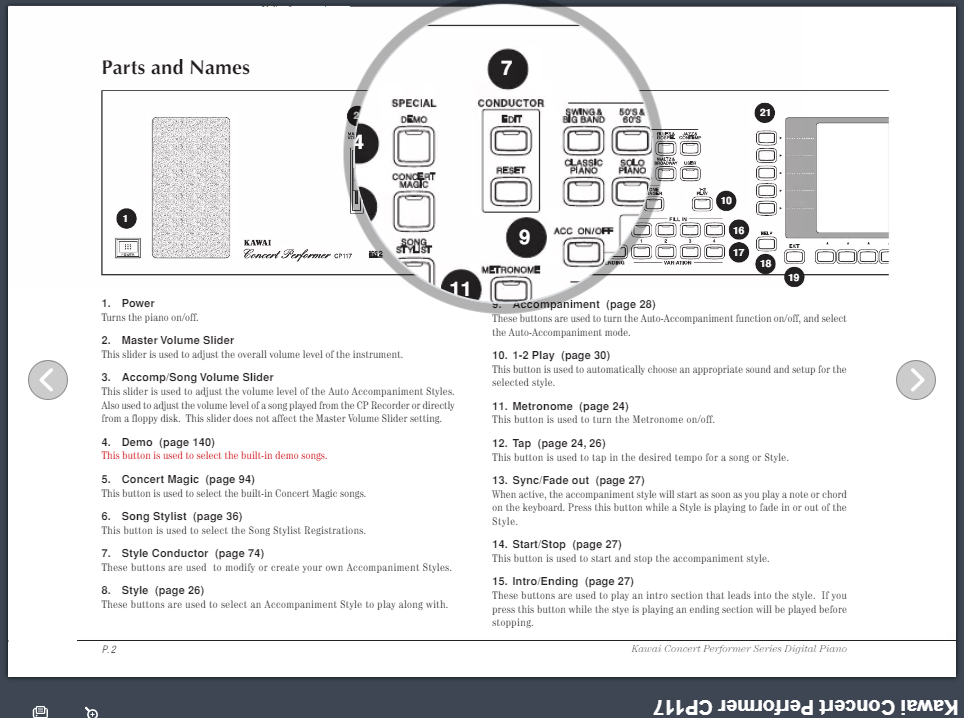

As an update, I was able to get this into an electronics repair company. They contacted technical support for Kawaii. Turns out, there is a reset button! It’s not identified in the user guide or technical manual at all, and it doesn’t look like it would be a system reset button. It’s under number 7 on the attached photo. Press and hold for 8 seconds.
