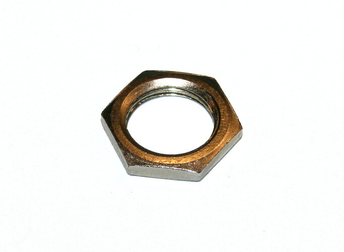

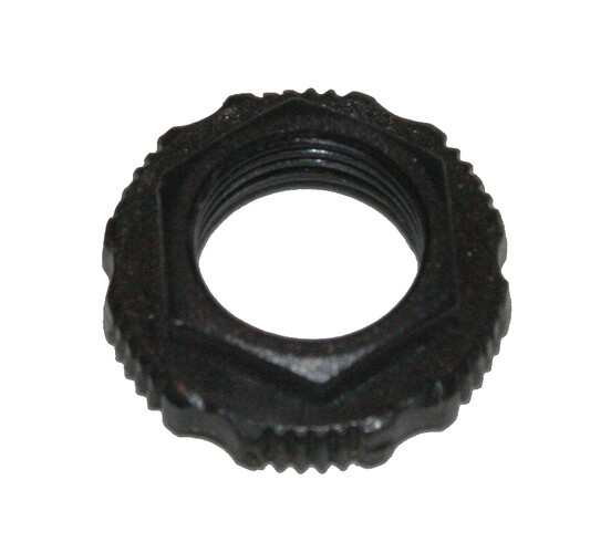

The parts I am looking for are the nuts used on the jacks on the rear of the synth. This is a Japanese one and the nuts are made of a plastic which has gone brittle over time. I am looking for metal replacements but I can’t seem to get the right thread. The jacks are made by Hosiden but I cannot find the model or part.

For the phone jack nuts, the original plastic one is here:
I have order the nuts from you today. I have been on the fence on if I should get it painted or attempt to create a template and design a wrap to go on it. As I will be installing Tubbutec mod as well I could incorporate the new features as part of the design. Alot of work and learning to do to get that done!
