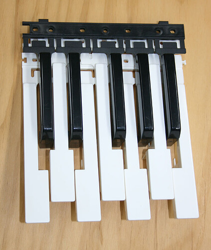

We don’t have info on which type of keys the Oxygen 49 uses. Is it possible you could post a pic of the troubled key?
Some Oxygen’s use key groups instead of individual keys:
If a key broke loose from the group, it would not stay in place correctly.
Other Oxygens use individual keys, and there would be a different reason for the key to be sitting up too high. So if we can first nail down which type of keys yours uses, that will help.
