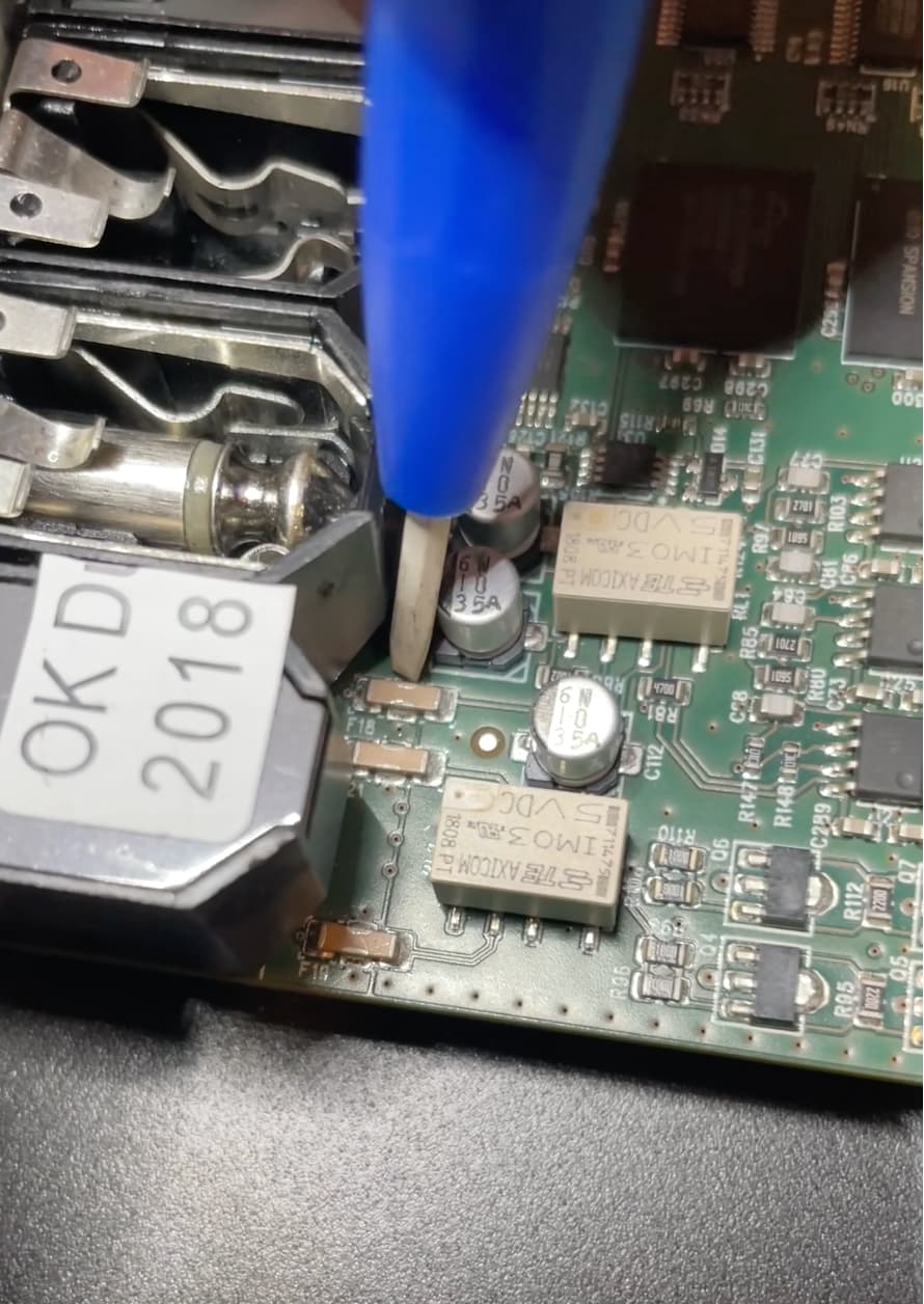

I fixed a problem like this on an Electro 6D last year. I noticed the channel would come back intermittently, and I finally figured out where to “press” on the board to make it fail, or get the signal to come back. On this Nord, the problem ended being with one of the tiny micro ferrite beads right before getting to the output jacks. Labeled “F” and the number. I assume they were ferrite, and not fuses, even though they are labeled “F”. I was able to resolder the culprit, and that fixed the issue.
