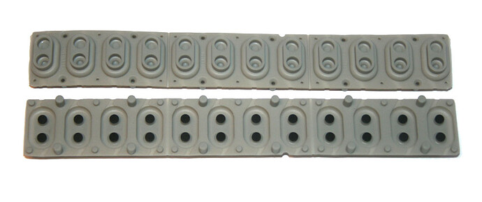

I believe that keyboard will use the same type of rubber contact strip that all Nords use:
The two contacts are at different heights, and by measuring the time difference between when they hit, the keyboard then calculates the velocity at which the key was played. This is how the keybed responds to hard and soft playing.
I’m not sure how that would translate to only B3 sounds playing on that one note - that is perplexing! But I would certainly try cleaning or replacing that contact strip.
