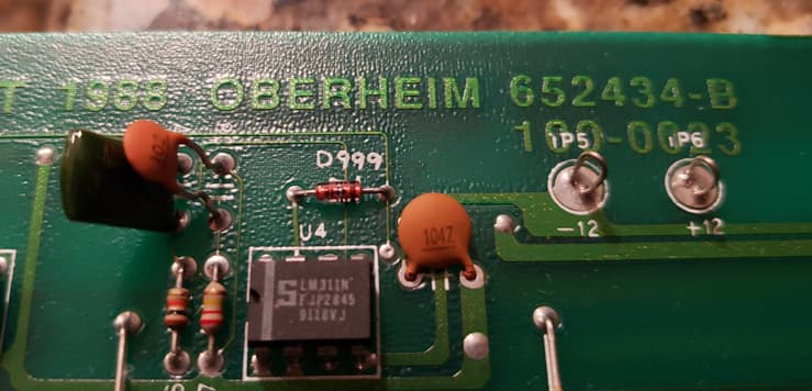

There is also an issue with older rev boards. 1.2 requires the latest board revision. A trace was added, and if yours doesn’t have it and it was never jumped with wire, it won’t work right. If your board has this diode, D999 then it’s the latest revision.

It already has the trace and works perfectly and smoothly with midi. I have the latest firmware 1.21. Battery is new.
