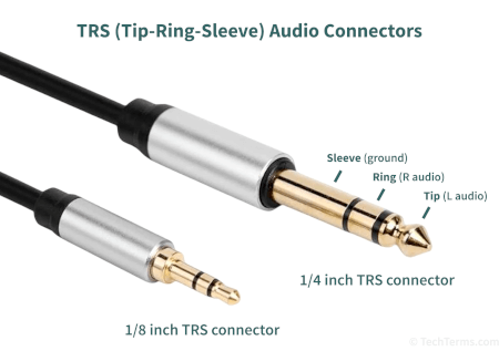

You could also put the headphones in - that’ll give you TRS Ring → right and TRS Tip → left.
I tried without the 1/4" adapter, and these were the results (with headphones plugged in).
When I touch either ring on the 1/8", I hear sound from the right side of the headphones. If I touch the first ring (closest to the keyboard), I hear a clipping. Second ring (farthest from the keyboard), I hear a loud, buzzing sound. When I touch the tip, I hear this same clipping signal sound from the right. I don’t get any signal on the left side of the headphones.
Thanks so much for your help again!
Just to get terminology clear
Would it be possible for you to plug it into a radio or phone of sorts?
Reading your previous I can almost assume that problem may well be the Master Volume pot … or maybe a connection between the jack board (where all the jacks plug into) and the little board that holds the Master Volume and power on light.
