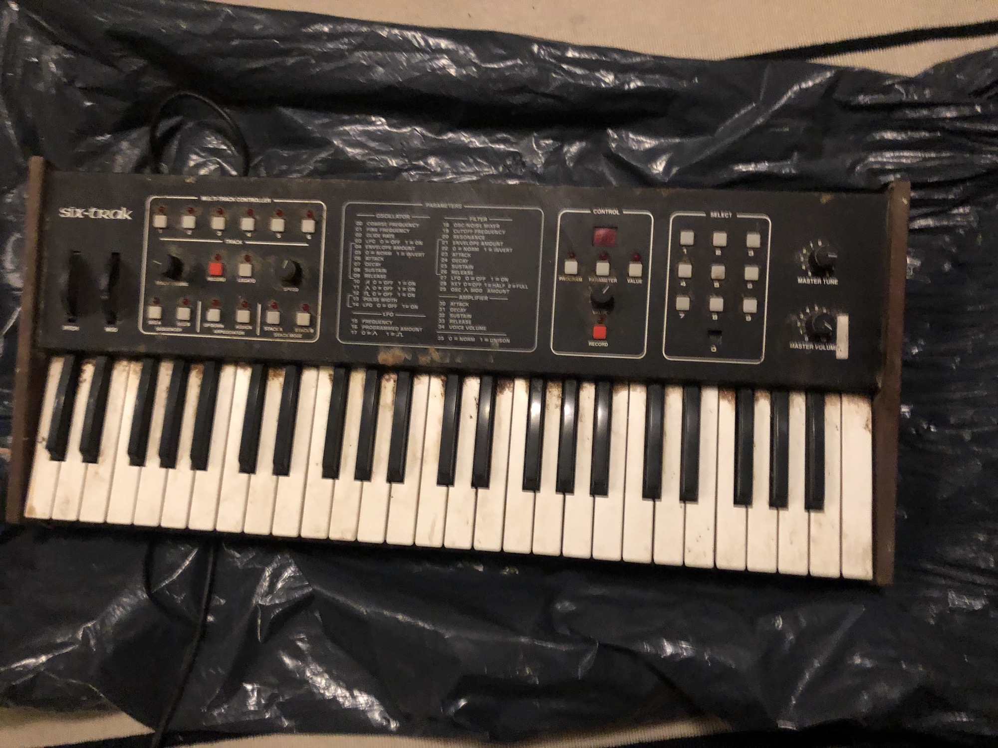

Hey there, I was lucky enough to get a Six-Trak for free from someone. I had to majorly clean this thing up since it was clearly in a very bad garage for a long time. Either way now that I have done that I plugged things in so far I get two-zeroes in the display (Seems good) but no sound comes out and none of the buttons appear to do anything. I have some electronics knowledge but I wonder if anyone has any info to get me started?
Did you find out what was wrong?
Hi there, I was able to find someone who was knowledgeable about this sort of thing who helped my debug things with an oscilloscope and it ended up being the CPU. I replaced the CPU and socketed it as well. Still some strangeness with the keyboard keys but I have been really busy over the last few months but it appears to mostly be dirt.
