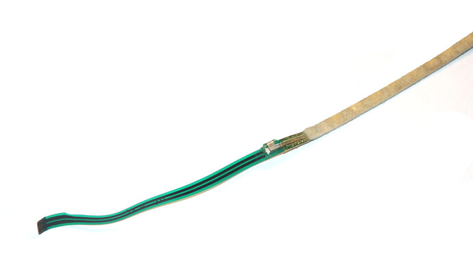

That wouldn’t be a fuse issue - a blown fuse would cause the unit to stop working until you physically replaced the fuse (restarting would not help). I’m also guessing that the aftertouch issue is a separate issue - if it stopped working and hasn’t come back, that could be that the ribbon cable from the aftertouch strip has gotten disconnected. Here’s a photo of it, and that green end plugs into a circuit board, but may have come loose. Or if that ribbon is damaged, the aftertouch won’t work.

Sorry, here the aftertouch strip pic:
I second sam about that strip. Ive reconditioned 4 D70s (im not an engineer/tech), i usually fixed the redglue problem with the sk760(?) keybed on my D70s and sometimes used a carbon/silver pen to redraw the broken paths on those old,cracking plastic keybed sensor boards sam is talking about. I’m sure Syntaur can figure it all out if you sent it to them.
