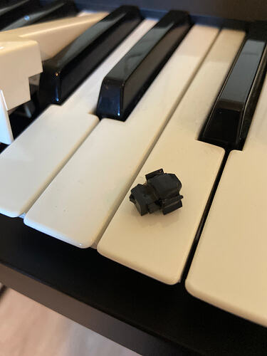

Otherwise pristine keyboard with 1 tiny broken bit! Upset, was looking forward to letting my children have a go at it. Is it possible to replace/repair?
Grateful for replies - thank you! :blush:
Elisabeth, Norway
β€’ Symptoms (what changed, when): Broken during years of storage.
β€’ This is the piece that is broken:
I don’t know if you have access to a 3d printer and how handy you are but with some digging and effort you probably could print up a new piece.
This looks like a key bushing. I think Syntaur has. Part #4344. .45 cents USD
Yes definitely a 4344 key bushing but looks like some of the plastic keybed chassis is snapped off too? You can reattach it with super glue or an epoxy for plastic.
