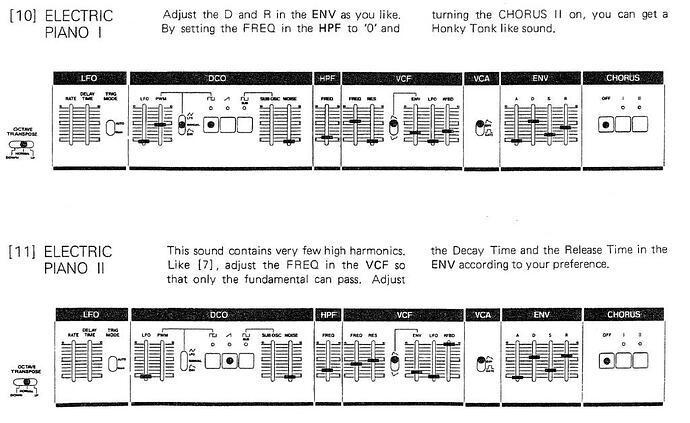

Loading patch panel changes doesn’t guarantee sound necessarily, but flipping through you should find something that makes some sounds. Put it in test mode or try to make one of the patches I have attached (I just realized that’s a Juno 60, but it should get you close)
It could also be a hundred other things, but try moving the HML switch back and forth. Sometimes those can get so dirty they make it not make sound. It could be a lot of other things, so if these don’t work, you should probably make friends with a local tech.
