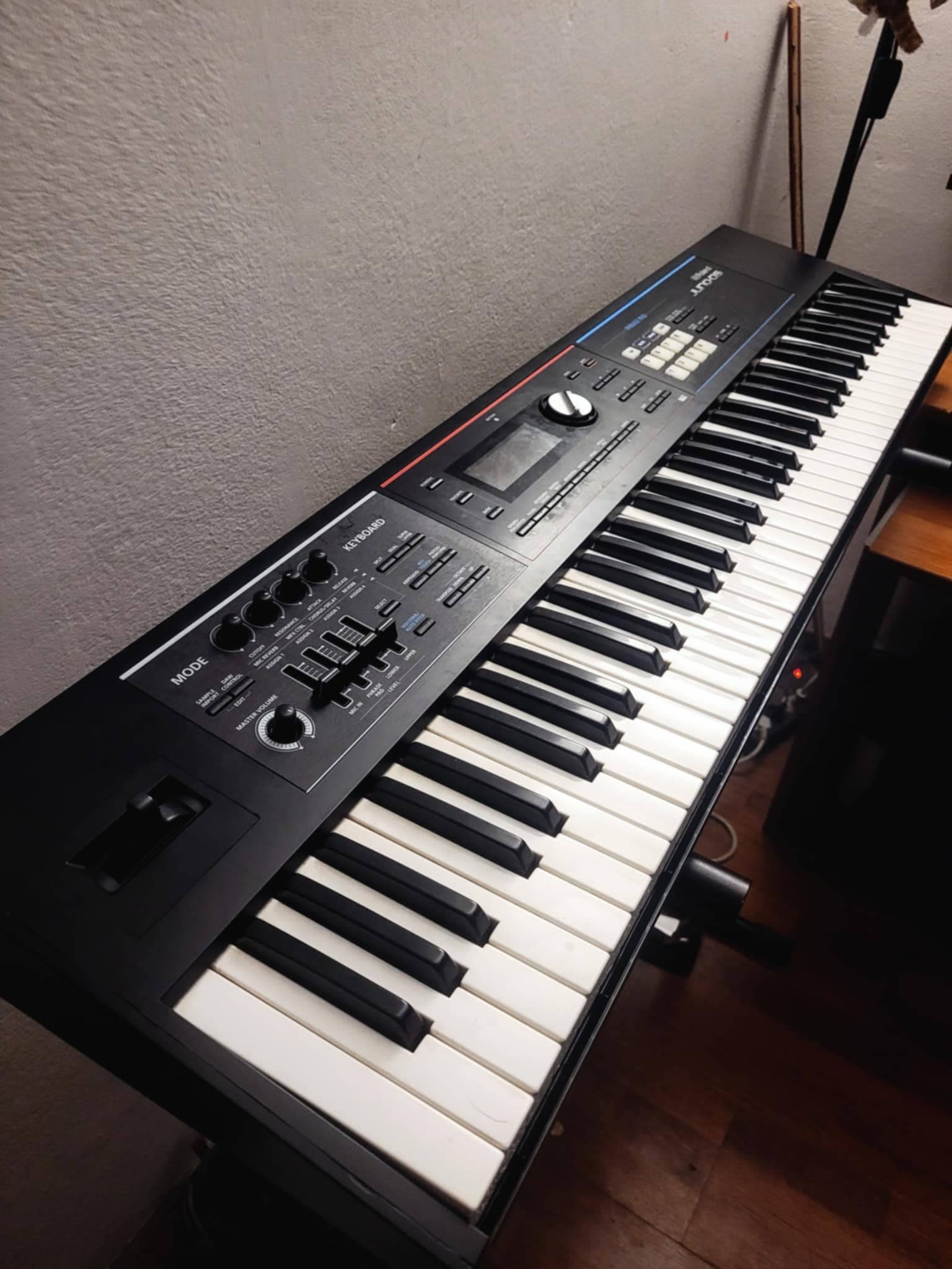

Hello guys,
I’ve recently customized my Juno-DS76 into compact version so that side plastic was completely cutoff and pitch joystick transferred to an empty space on top. I’ve also swapped the keybed and borrowed one from Roland A-30 to get a better playing feel - suprisingly, my service guy told me that keys are virtually the same so no adjustment was required. However, A-30 keybed gave me better playing action.
So, right now, I’m thinking about swapping joystick into pitch wheels. I found out that I definitely prefer mod wheel separated from the pitch. So… I’m curious to find out two things:
  1. Is there any certain thing / spec I should monitor before I order wheels? I mean, can I use the Roland pitch/mod board and just attach it to the wheels instead of joystick?
  2. I have Alesis Ion and Fusion and I really love their transparent + LED aesthetics. Not sure if I order Fusion or Ion wheel board do I get LEDs as well and would it be poissible to implement such solution into Juno-DS?
