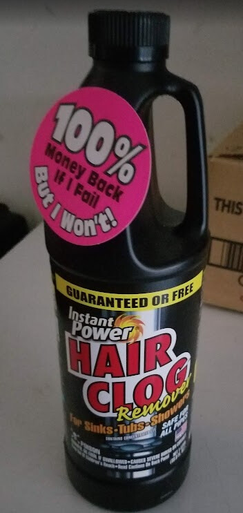

For some reason, my reply email was blocked… Sorry about that. Kroger has a hair clog remover which contains Lye. Nasty stuff on skin, but cleans out the red epoxy just great. Rinse the keys well before handling. It’s called Instant Power Hair Clog remover. It’s In a black bottle. If I could post a pic, I would.

This is what I used to get the Red Goo off the keys. I put the keys in a large glass pickle jar ( the largest I could find at the time) and let them soak for 48 hours. It did a great job and the chemicals did not affect the original keys at all. I replaced the weights and glued them in with a 2 part Gorilla Glue Epoxy and have not had any problems at all. As far as the aftertouch strip is concerned, any alcohol will soak into the felt strip and remove the adhesive backing and getting the red goo out of the felt strip…really forget that. Syntaur have the upper keyboard (key return) strip for about $15 or so, but the aftertouch strip does not work well if you sub the upper felt strip for the aftertouch felt.( I tried it and some keys sounded and some keys don’t) Its just too thick. perhaps try and source it from Amazon or a piano manufacturer, but unless you can get the original part, you might be out of luck. I don’t think there is any useful technical detail that will describe how thick the AT strip felt should be. As for the board being stored on its back…the goo has probably got onto the chassis, key springs, and the contact pads, etc, which you probably need to replace anyway if the keys are not sounding.
