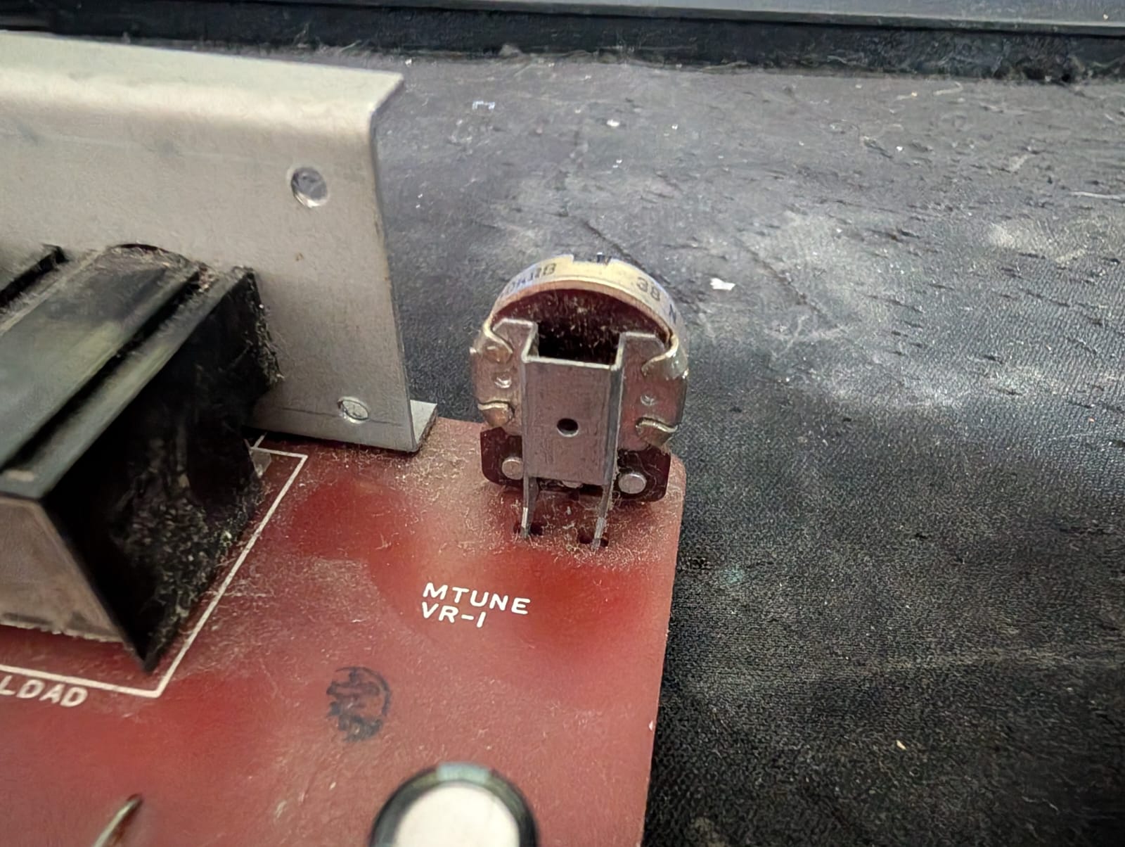

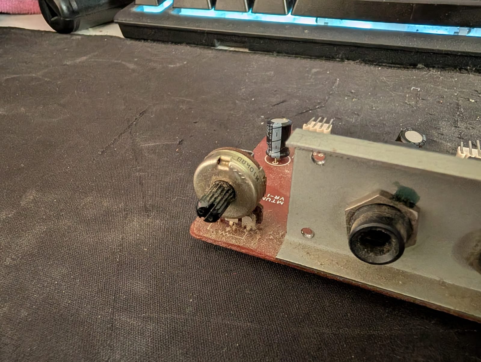

The potentiometer in question 10k B, sometimes it can become more loose than usual and I have seen that the back of the pot becomes detached from being bumped. I’ve included some pics of a spare I have laying about for reference. I haven’t look on the shop but I’m guessing it comes with the whole jack board assembly.
You should be able to replace the whole thing.
Save having to buy a whole board.

if the back of the pot physically moves when you jiggle the pot, its time to replace the pot. I would say something has let go inside the pot for that to happen.
I don’t see a replacement on Syntaur’s site so you may be forced to open it and repair it. I’ve not seen a mounting like that in decades so finding a like replacement is virtually impossible.
