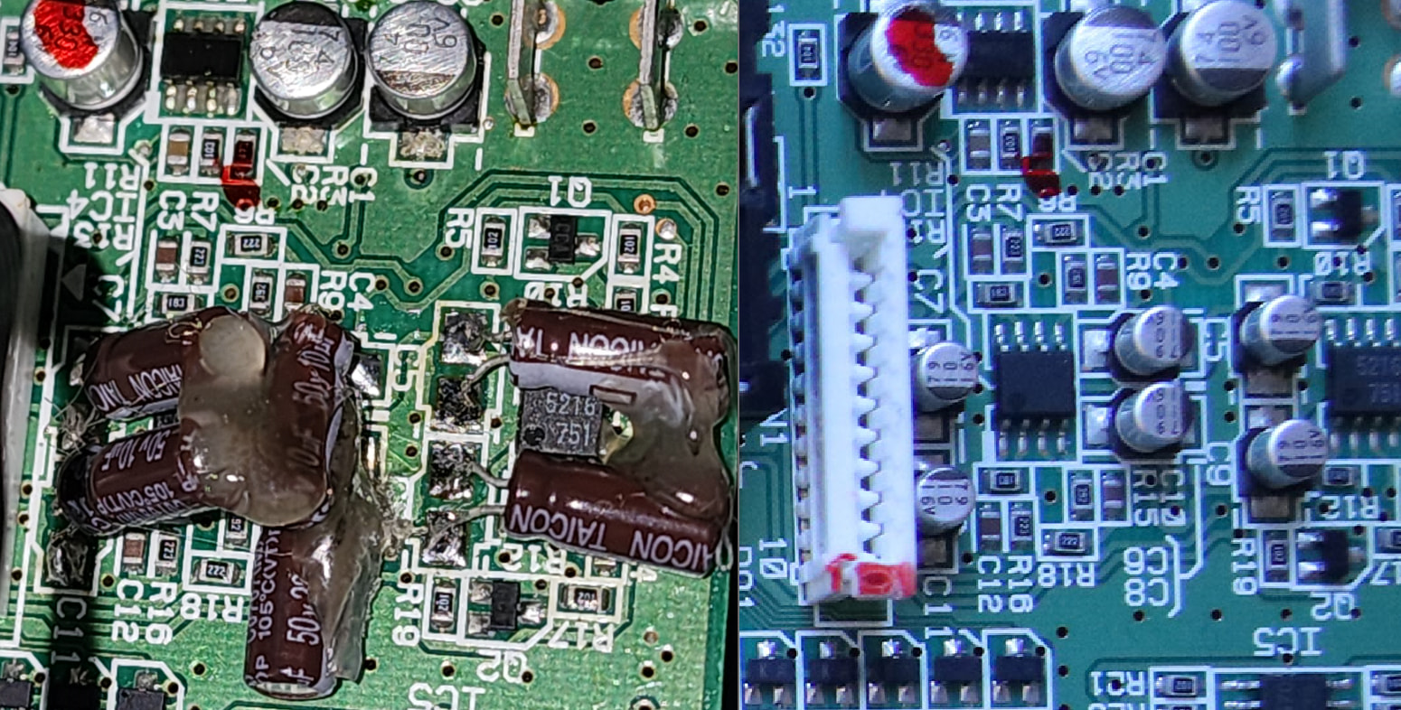

Here are some photos of the board with the new capacitors installed, now I see that not all of them were replaced. Maybe I need to replace all of them.
do you know of a place that can replace them?
(original capacitors on the right, on the left is what the shop used to fix it. but it’s not 100% working)
That’s a proper mess! Some of the caps aren’t the correct values either.
They should have used like for like parts.
Whether this is the cause of your issues is uncertain, but needs resolving before you continue.
