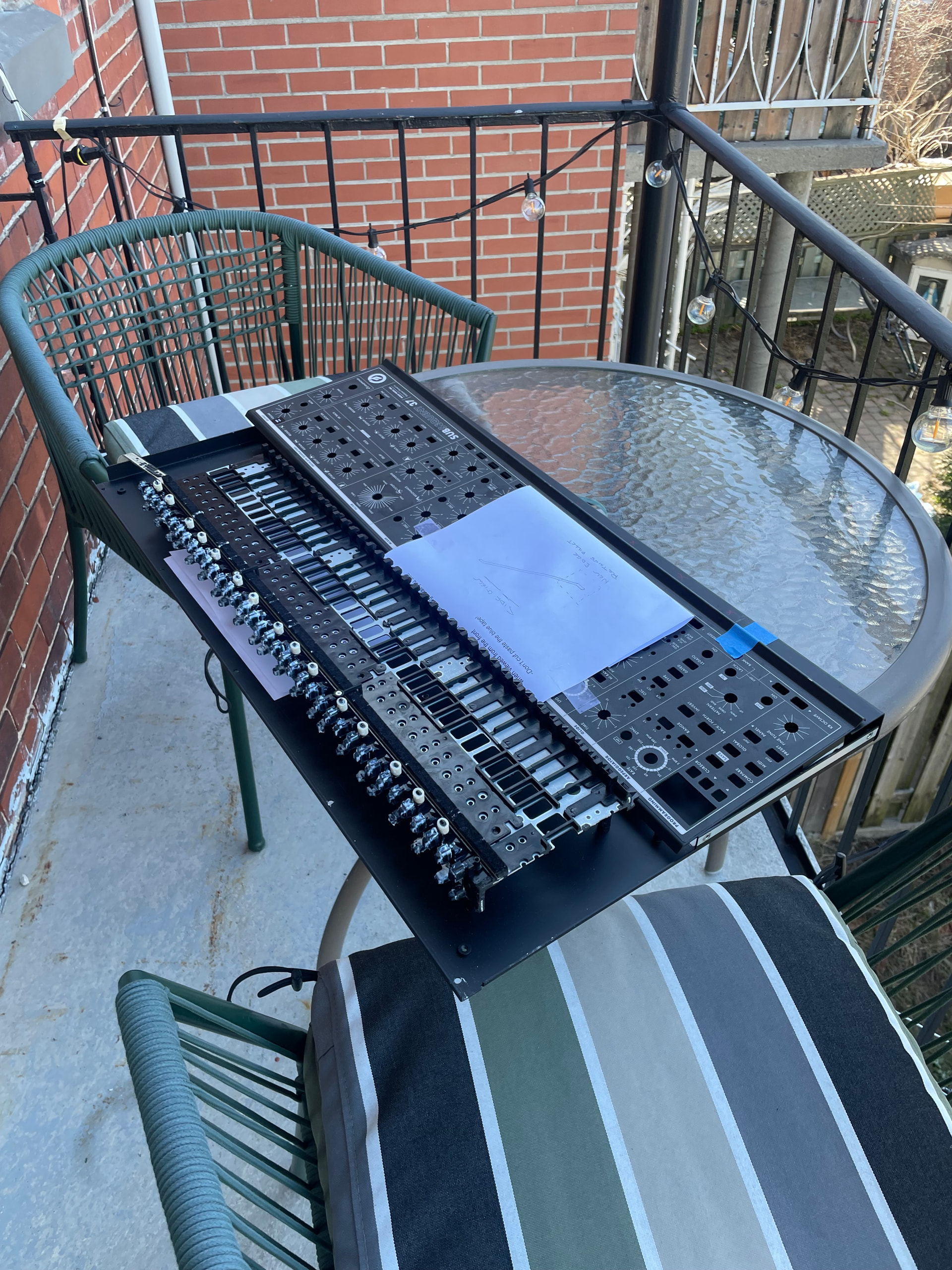

Hey everyone,
I’m working on a Fatar TP/8SK keybed and was curious about the white grease used on the rubber key stop bushings (the thick, creamy stuff where the key bottoms out, see pictures)
I’ve gone through a bunch of threads here and elsewhere, and there seems to be a lot of back and forth, mostly pointing toward silicone/dielectric grease (or Super Lube O-ring grease) but I haven’t really seen a clear consensus on what’s closest to the original.
Has anyone come across the actual factory grease (or an exact match, if there is one)?
If not, what have people had the best results with in terms of keeping the original feel?
Not trying to overthink it, just figured I’d ask before experimenting too much.
Thanks!
