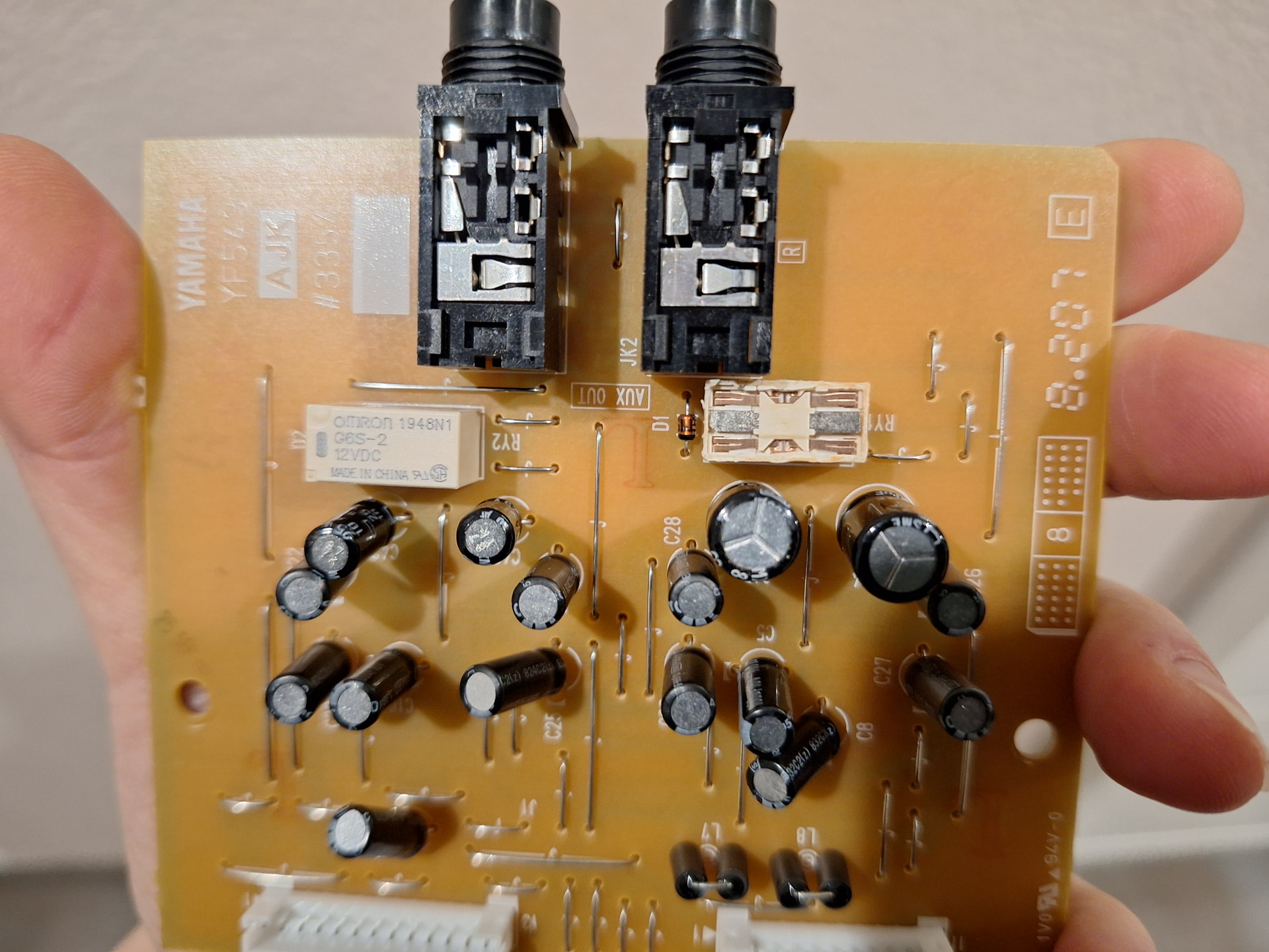

I took a look at the Jack Board where the headphones are inserted but it looks ok and clean.

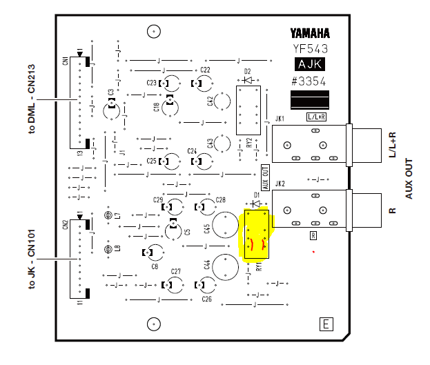

Had same/similar a few years back - after long troubleshooting, because fault comes and goes, it came down to relay RY1 on the AJK board (see yellow in picture). That is easy to replace - very common part to be found in any electronics store.
As a matter of fact - you can proof the point - remove the relay and add two little wires (red lines in the picture) to hard wire the signal path - if the fault permanently disappears it was/is the relay, if not … have to look further back in the path.

First I had to find out that I have to remove only the three screws at the top of the backside and slide off the top of the synth.
Then I measured which contacts are normally closed and which are closed when the clavinova is turned on with or without headphones (which is actually the same). I don’t know when the relay is not powered aside from the synth powered of.
One fact I noticed: the continuity beeper was beeping shortly on both poles which should be open while powered. This was not the case with the left channel.
So I followed your instructions, removed the relay and bridged the contracts and it worked!
Now I actually didn’t order a new relay yet and opened the relay to have a look inside and switched it manually a few times. I don’t know what was causing the issue, but now with the opened relay (covered it again) the problem is gone for now.
