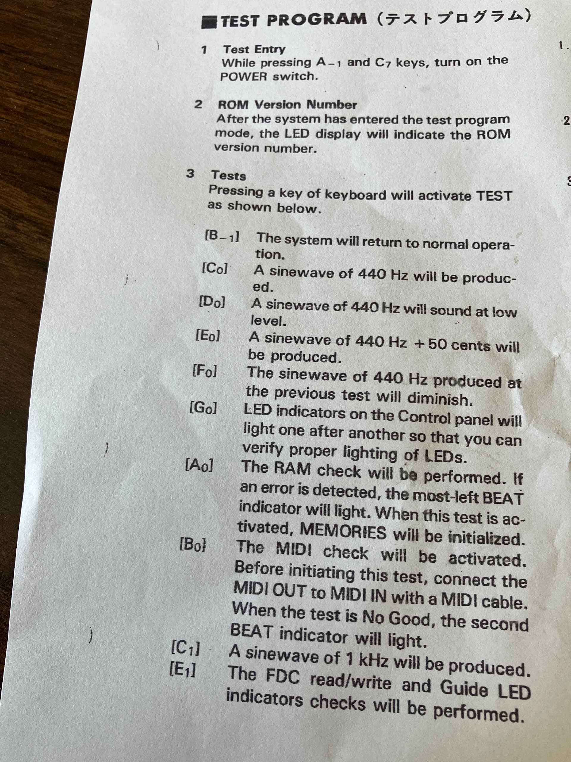

I checked the power supply over and it looks ok. I found the service manual and the instructions for the test program (image below). The tests seemed to check out with the following exceptions:
Ao: Indicated a RAM error.
E1: Did not work.
After running the RAM check test it almost seems like things are worse now, as the autoplay tracks seem to freeze for a sec before picking up again.
