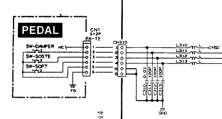

Just took the piano apart again. Looks like I’ve got the cable but am just missing the male pin connector. Purchasing a couple options.it’s a 2x3 connector. Not quite sure which of the 6 wires will go in which slot… :sweat_smile:
