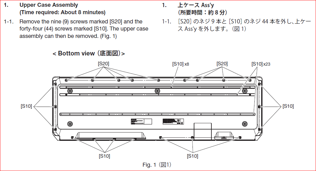

Hello, I removed all the case screws around the perimeter of the back, sides and bottom and cant get the MX 88 case open, Yamaha wont sell me a service manual. are there more screws om the bottom that need to come out? or just pry harder, I didn’t want to break the plastic case. any help will be appreciated, Thanks,
Charles
