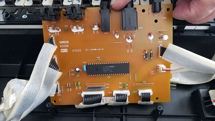

The power connector is loose. I am looking to just replace the circuit board but an unable to find one online. The only thing printed on the board is "Yamaha #2688 XY503.
That circuit board is no longer available from Yamaha. But if the connector itself is not broken, you should be able to just reflow the solder and be good to go.
