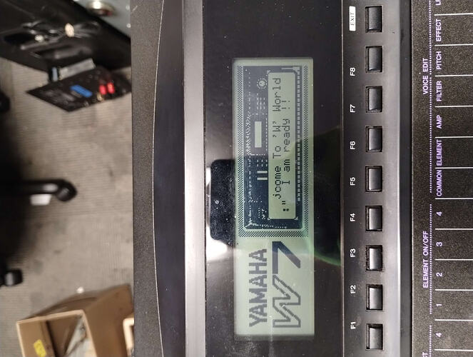

• When I power the keyboard up it will show the yamaha logo and got to the screen with W7 and “Welcome to W World I am ready” It then reboots and gets to this point again without ever going past. There is an issue with the text at the W7 screen where the W is replaced with a J (See photo below)
